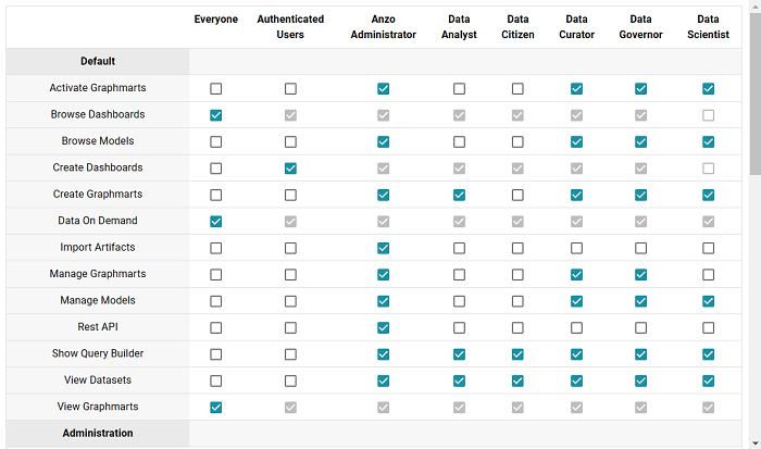

To view an overview of the configured permissions for all Anzo roles, you can view the Permissions page under the User Management menu in the Administration application. The screen displays a table; the heading row lists each role, and the first column lists each permission. The permissions are grouped into categories, such as Application or Data Onboarding. For example:
The rows for each role column include checkboxes that control permissions. You can select or clear checkboxes to enable or disable permissions for a role.

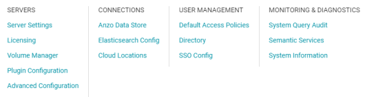

The image below shows the view of the Administration menu that users have if Administer System Setup and Anzo Application are the only two applied permissions:
Some menu items in the above image, such as Semantic Services, AnzoGraph, and Anzo Data Store, are also controlled by more granular permissions: Manage Semantic Services, Manage AnzoGraph, and Create Anzo Data Stores. To give an administrator full create, modify, and delete access to those functions, the granular permissions need to be enabled in addition to Administer System Setup.
