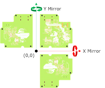

- Mirror: Create the duplicated original PCB data by mirroring.
- X Mirror: Mirroring the board based on the X axis.
- Y Mirror: Mirroring the board based on the Y axis.

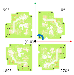

- Rotation: Create the duplicated original PCB data by rotation.
- Rotation Angle: Enter the angle to be rotated. The rotate direction
is counterclockwise.

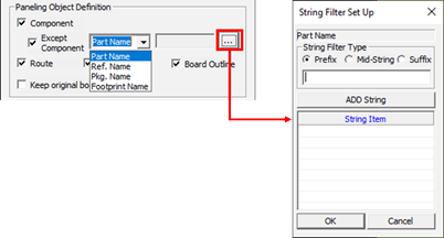

- Component: Include components placed in PCB data.
- Except Component: Exclude duplicate components. Exclude components
can be specified in the String Filter Set Up
dialog.

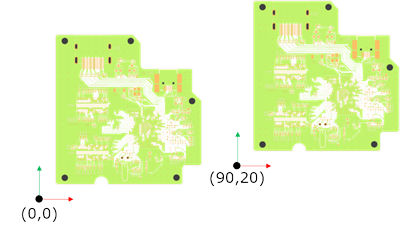

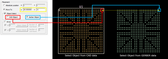

- Move To: Define the X and Y coordinates where the duplicated PCB
data is placed. The origin coordinate of the original PCB data is
used as the reference point.
Figure 4.
- Object Select: Automatically calculate the movement coordinates by selecting
the pad of the PCB data and the pad of the Bare Board Gerber (Metal Mask)
data in an array.
- Cad Object: Select the reference pad on the PCB design data.
- Gerber Object: Select a pad object that matches the pad selected in CAD data.

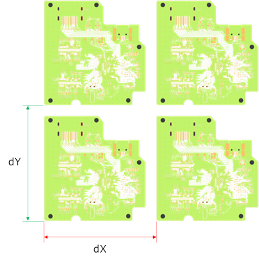

- Array: This function is used when the duplicated data is to arrange with the
same distance and angle.
- dX, dY: Set the X and Y axis spacing of the copied sub board.
Figure 6.
- Select Object: Automatically calculate dX and dY spacing by selecting two parts from PCB design data.
- Number of Sub Board: Set the number of sub boards to be duplicated in horizontal and vertical directions.

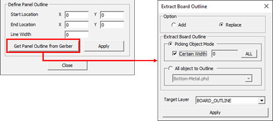

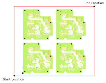

- Define Panel Outline: Create panel outline by designating an area of the
bare board’s location.
- Start Location: Specify the starting coordinates of Panel Outline.
- End Location: Specify the ending coordinates of Panel Outline.
Figure 7.
- Line Width: Specify the width of Panel Outline.
- Get Panel Outline from Gerber: Designate the line selected in Gerber
data as the Panel Outline.
Figure 8.
