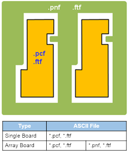

PollEx PCB supports two types of board types: single and arrayed board to read Zuken CR8000/CR5000. The array board file, *.pnf, should contain single boards information and single board files, *.pcf, should also exist in the same folder.
| Type | ASCII File | |
| Single Board | *.pcf or *.dsgf, *.ftf | |
| Array Board | *.pnf or *.mdgf, *.ftf | |
