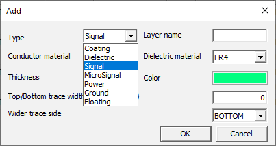

selecting one of the drop-down values. Layer Type for power plane should be defined
as Power and ground plane as Ground as displayed above. Available layer types are
coating, dielectric, signal, micro signal, power, ground, and floating layers. Each
layer type is described below:

PollEx PCB provides default layer stack set and user can add
or edit layer stack by clicking Import or
Export. The default layer stack file path is:
Installed directory/V6/Data/Layer. You can add, remove, or
insert each layer by clicking Add,
Remove, or Insert. By selecting
this menu, the Add dialog opens wherein you can set material
characteristics. You can export stack-up information as an Excel file.Figure 1.
