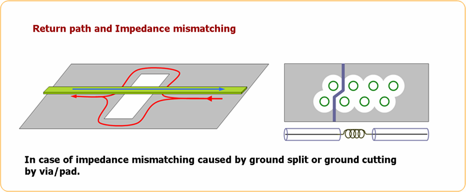

In many cases, designers use inner layer vias to get routing space on a board. If
inner vias are used for highspeed signal trace, they may cause a problem when common
signal traces are routed above or below the inner via. High speed signals via can
give bad influence to common signal. This structure results in small crosstalk, but
if the signal is in quite status and connected to outside of board, common signal
could be activated as antenna. And this structure causes EMI problems.

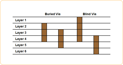

Since BB vias cannot be easily visible and placed in inner PCB layers, they may be placed under a high-speed signal and may generate noise by impedance mismatching. Because of such reason, designers should be careful while placing BB vias.
BB Via: Buried Via, Blind ViaFigure 1.
