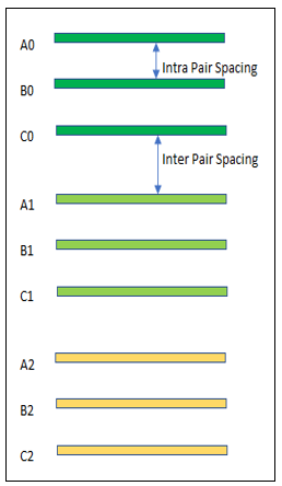

- Type: Define separation measure base.
- Value: The clearance value is considered as Separation Value.
- Width: The value is considered as multiple of Pattern Width.
- Intra-Pair Spacing (Min): Allowable minimum spacing between net.
- Inter-Pair Spacing (Min): Allowable minimum spacing between pair.
- Intra-Pair Skew(Max): Allowable maximum length skew between net.
- Inter-Pair Skew(Max): Allowable maximum length skew between pair.
