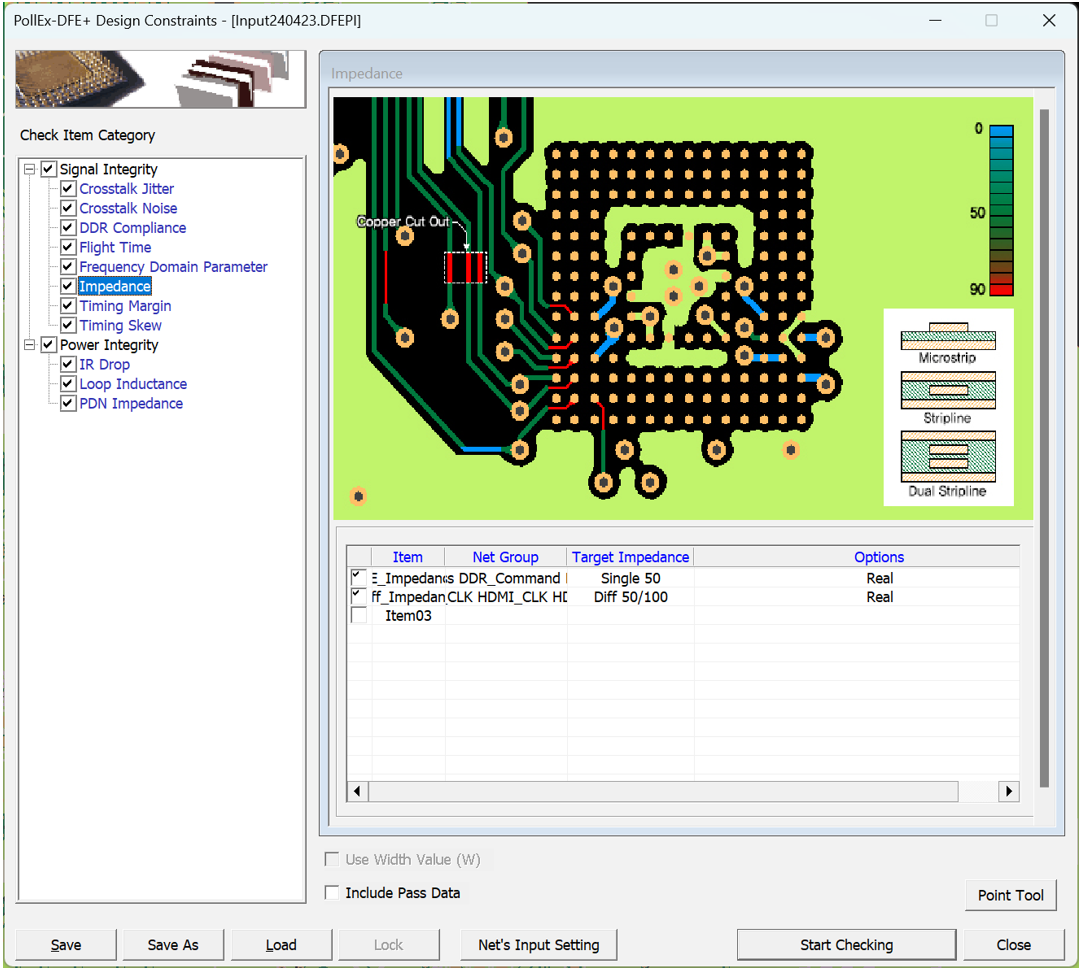

Impedance
This item analyzes and checks single-ended and differential impedance of target nets.
This item checks the followings:
- Check the single-ended impedance.
- Check the differential impedance (Characteristic, Zdiff,
Zcommon).
- Item: Enter sub item name. User can enter arbitrary name.
- Net Group: Select target net groups to be tested. Allow multiple net groups.

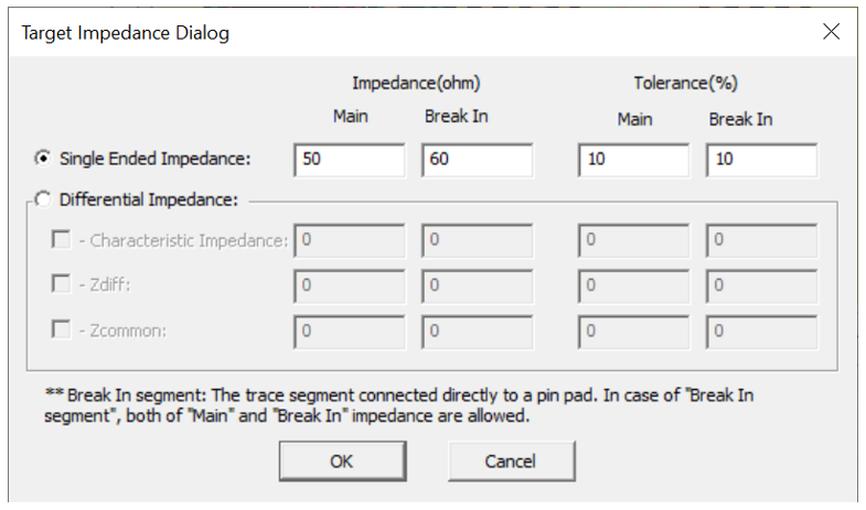

- Target Impedance: You can assign required impedance for main area and break
in area. You can also set tolerance (%) for each main area and break in
area.
Figure 3. Break-In/Out Definition
- Options: You can assign PIN/VIA Escape length and other options.

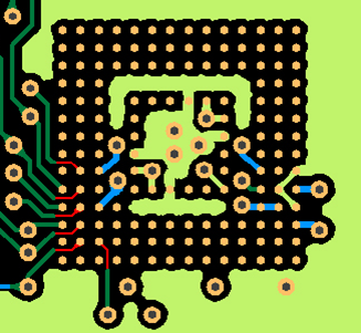

- Break-In range (COC+distance): Enter Break-In range value. The break-in
range refers to the sum of the distance within the COC line and the user
defined distance outside of COC line.
