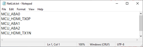

- Net Define File: Select a net definition file. The contents of the
file are shown below:
Figure 1. Net Definition File Contents
