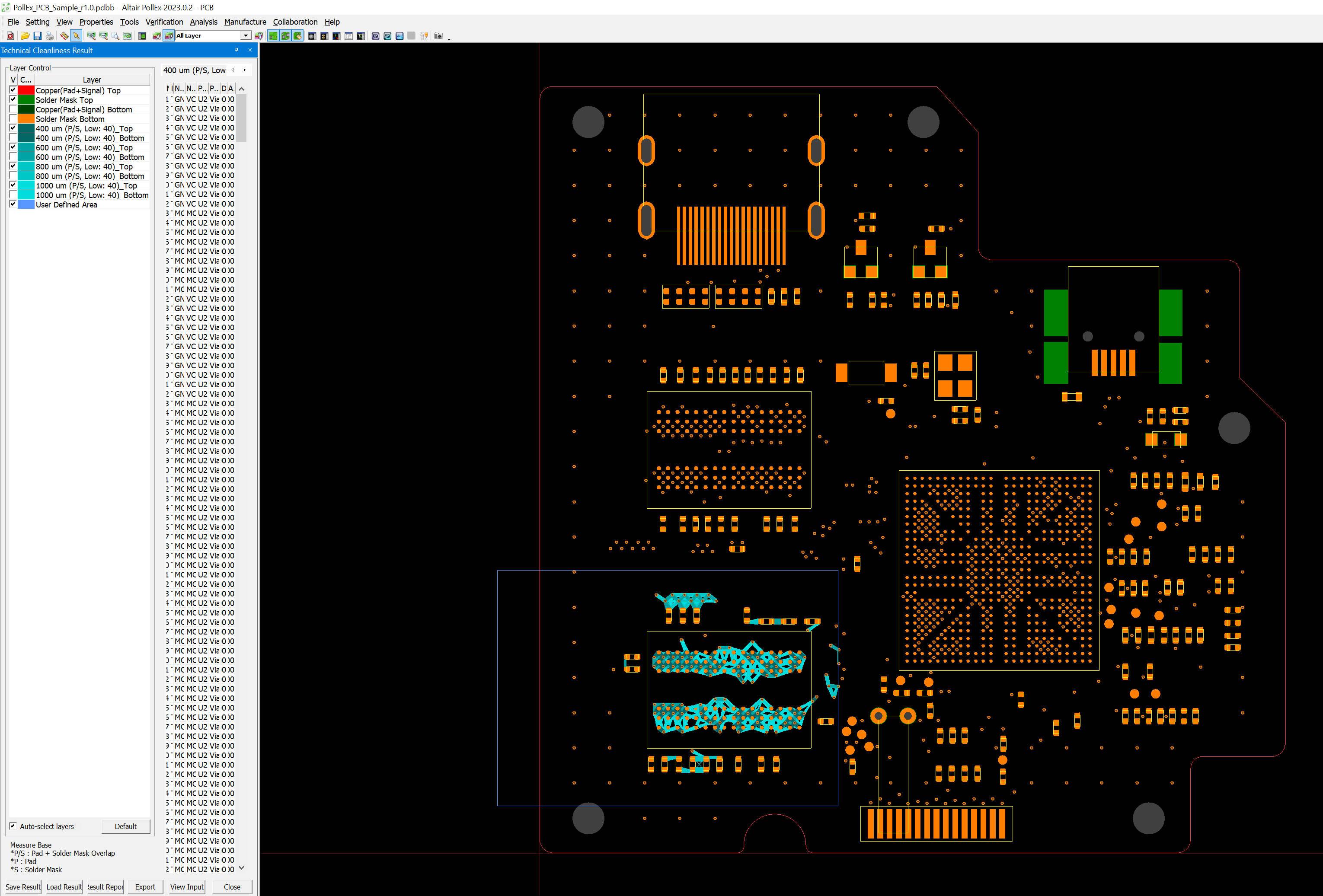

The initial result window is as follows:
Layer Control - This section shows the test categories and areas.
User Defined Area - This layer is for the user specified section
selected before analysis. The set area is highlighted in Blue
Default - This button resets the layer control to its original
settings.
Save Result - This button allows the result data to be saved.
Load Result - This button is for loading the result data (TECR) file. The
saved result data can be sent to others separately to enable sharing of the
result.

Show All Hazards - This button restores the result display to its default
view.
Result report - This button allows the result data to be saved in an Excel
file format.
