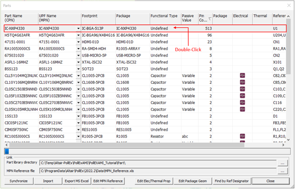

Click .
The Parts dialog opens.
Click Pin Count twice to sort the results.
The passive component RLC values are automatically extracted from PDBB data if the value property was correctly assigned in the PDBB database.
Double-click IC-NXP4330.

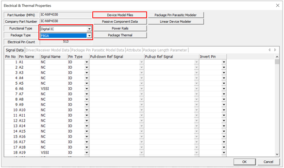

The Electrical & Thermal Properties dialog displays.
- Select Digital IC as a Functional Type.
- Select FBGA as a Package Type.
Click Device Model Files.

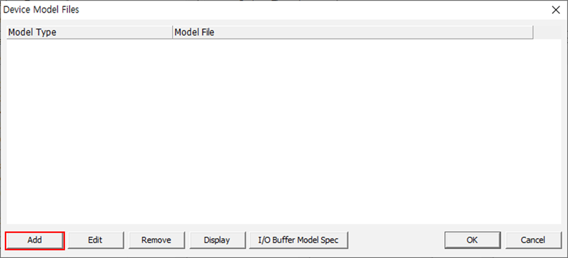

- Click Add.
For Model type, select EBD.
Figure 4.

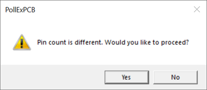

When the IBIS file contains numbers of different pin count, the message like below is popped up. In this case, you click Yes.

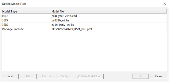

The Device Model Files dialog displays. The EBD, IBIS, and Package Parasitic are displayed.Figure 6.

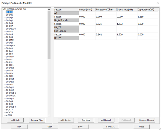

Select the Package Parasitic and click Display to view
the Package Pin Parasitic Modeler.
Figure 7.
- Click Close to close the Package Pin Parasitic Modeler dialog.

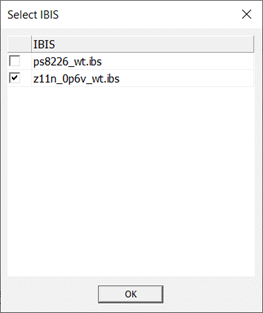

Select the IBIS file (z11n_0p6v_wt.ibs) as a memory IBIS
model.

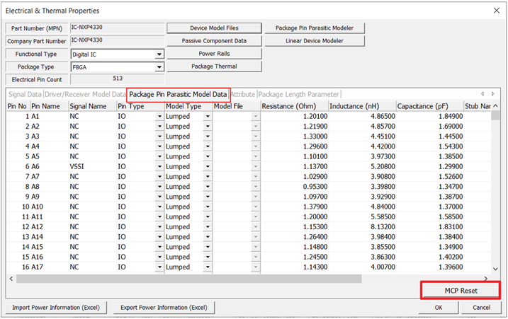

Click Package Pin Parasitic Model Data tab. Click
MCP Reset to verify the detailed information for each
pin.
Figure 9.

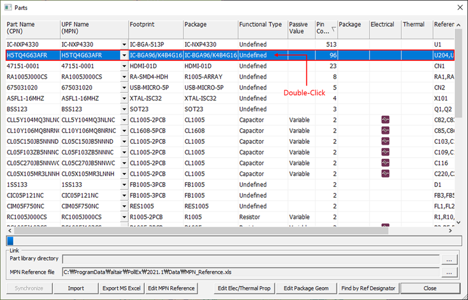

Figure 11.

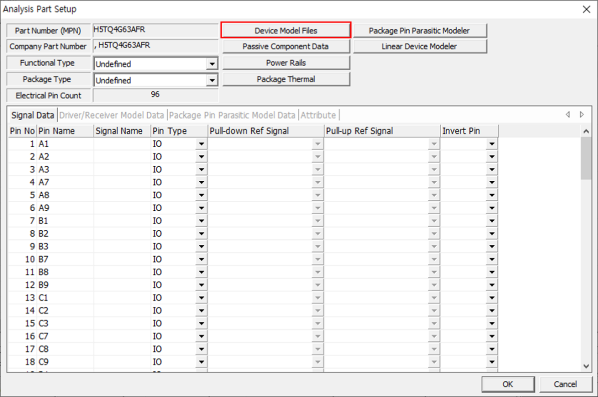

Double-click H5TQ4G63AFR.
Figure 12.
Figure 13.

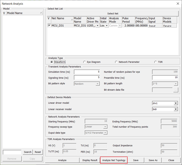

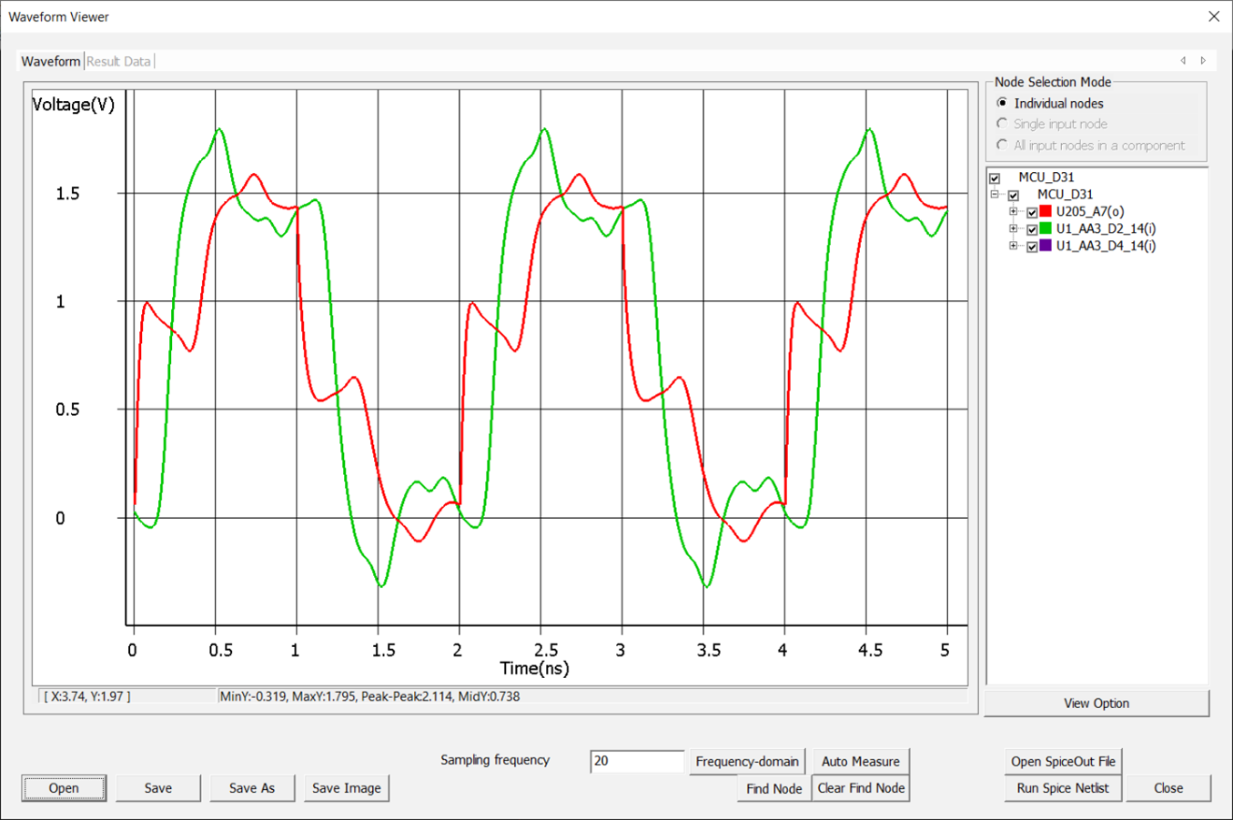

Explore the Waveform Analysis
Select .
The Network Analysis dialog opens.

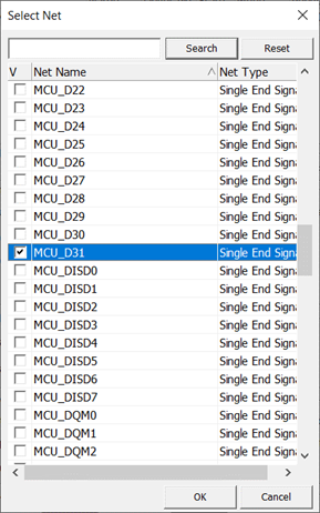

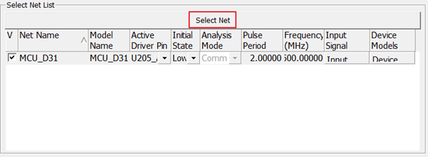

Click Select Net.
Figure 16.
Select MCU_D31 and click OK.
Figure 17.

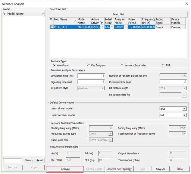

Set Frequency for the signal on Network analysis dialog.
In this case, 500MHz is set.

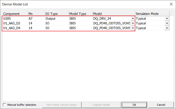

Click Device in the Network
Analysis dialog.
Check the connected components and pins to the selected net using the Device Model List dialog.
Figure 18.
Click Analyze.
When the waveform analysis starts, electromagnetic simulation extracts the SPICE model for the selected net. The excitation source signal is applied to the net which is specified by the assigned pin model’s operating characteristics and the values defined at Input Signal and Pulse Period. When the simulation is done, the Waveform Viewer opens or exploring the waveforms.
Figure 19.

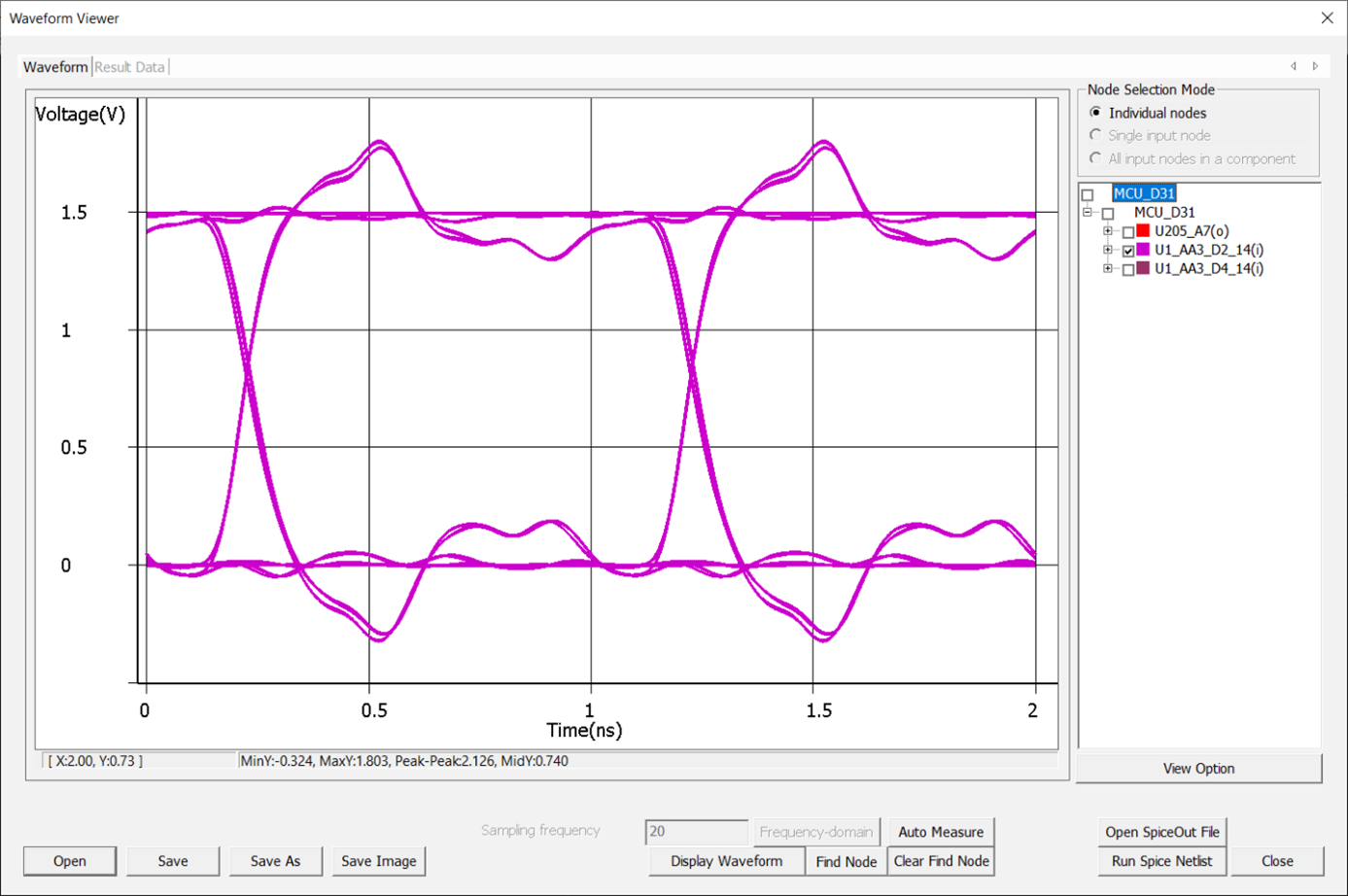

Waveform Viewer dialog opens providing all waveform for TX and RX.Figure 20.

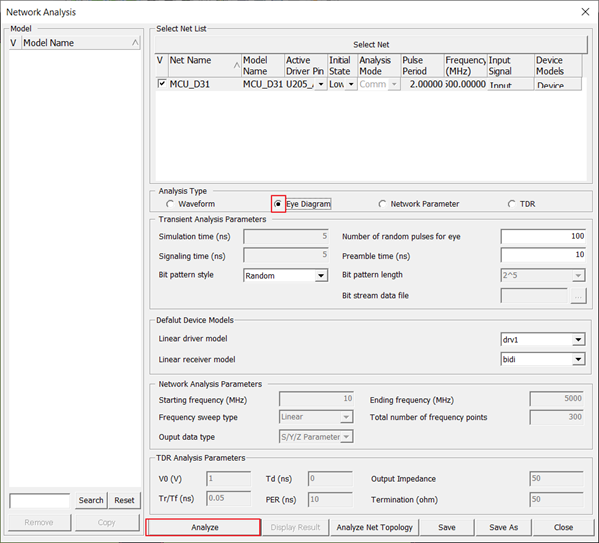

Explore Eye Diagram Analysis
- For Analysis Type, select Eye Diagram.
Select the desired net MUC_D31 to analyze.
Figure 21.
Click Analyze.
Waveform Viewer dialog displays.
Figure 22.

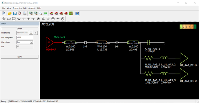

Click Analyze Net Topology.
The Net Topology Analyzer dialog opens.
Figure 24.
