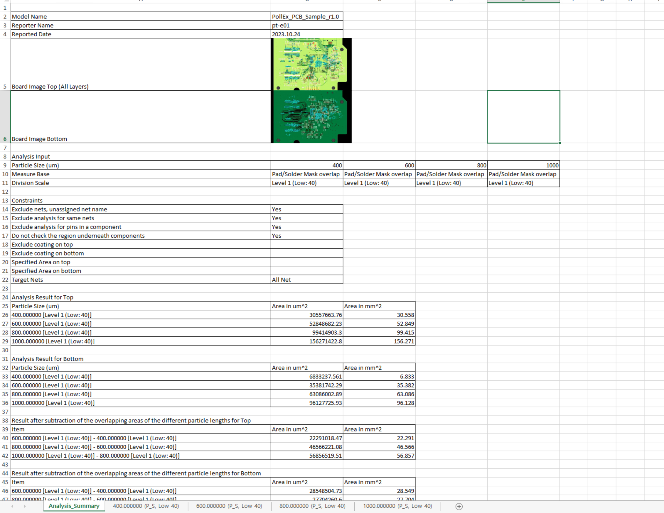

Export the Result Report.
- Click to export the result to Excel.
- To view, open the Pollex_PCB_Sample_r1.0.xlsx file located at: C:ProgramData\altair\PollEx\<version>\Examples\Verification\TechnicalCleanliness.
Figure 2. Result Report
