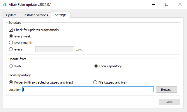

- On the Altair Feko update dialog, click the Settings tab.
Under Update from, click Local
repository to update from a local repository.
Figure 1. The Altair Feko update dialog - Settings tab.
