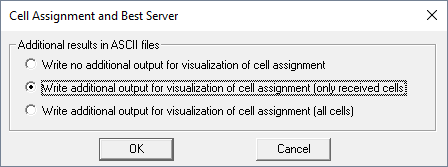

Additional Results
To visualize the cell assignment and the best server, additional result output is required. Click Project and click the Network button and select the Settings button for Best Server (Cell Assignment)
- Write no additional output
- No additional ASCII output for visualization of the cell assignment will be written.
- Write additional output
- Write additional ASCII output for the visualization of cell assignment either only for the received cells or for all cells of the network.

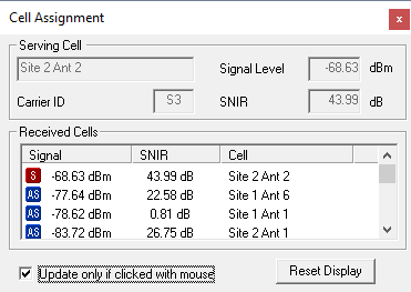

If additional ASCII output was enabled and you load a cell assignment from the tree view, you will be asked if additional detail of the cell assignment should be loaded.
The additional information about the cell assignment, such as serving cell, received signal level and signal-to-noise-and-interference-ratio is displayed in the Cell Assignment dialog after clicking on a receiver pixel with the mouse. Besides the serving cell (S), the links to the other received cells (AS), or all cells of the network (AS and NR), are listed in the lower part of the dialog.
