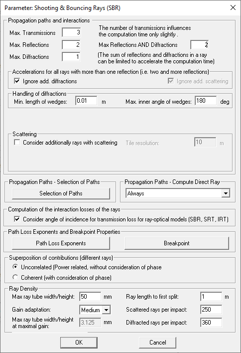

Figure 2. The Parameter: Shooting & Bouncing Rays (SBR) dialog.
- Propagation Paths and Interactions
The Propagation paths and interactions group allows to specify the number of interactions that should be considered for the determination of ray paths between transmitter and receiver including the maximum number of reflections, diffractions and scattering. To accelerate the prediction, additional diffractions and transmissions can be ignored for all rays with more than one reflection. The minimum length of wedges where diffractions can occur can be specified in meters. The maximum inner angle of wedges can be specified in degrees. When a curved surface is approximated by many triangles, those may form many wedges for which a calculation of diffraction is not needed. This option enables you to exclude such diffractions and save simulation time. In case the simulation database contains ground objects (topography in vector format), interaction at those objects can optionally be considered. Diffuse scattering in indoor scenarios can play an important role, especially for determining the actual temporal and angular dispersion of the radio channel.
The WinProp SBR model was extended to consider the scattering on building walls and other objects. For this purpose the scattering can be activated in the model settings by enabling the option “Consider additionally rays with scattering”. As the scattering increases the overall number of rays significantly, there is a limitation of one scattering per ray. Furthermore, the surface roughnesses of the corresponding materials need to be defined (in WallMan and / or ProMan).
For the scattering in the SRT model, tiles as defined in the dialog are considered. The scattered contribution is weighted with the size of the scattering area (tile). Accordingly the resulting scattered power from the whole object is for large distances independent of the tile size. For small distances there is an impact due to the modified scattering angles which depend on the tile size.

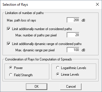

This option allows the limitation of the number of paths per pixel with the following options: maximum path loss of rays, maximum number of paths or dynamic range of paths.
Figure 3. The Selection of Rays dialog.
Tip: The computation time of SBR can be reduced significantly by reducing the Max. path loss of rays. Rays that encounter too much path loss will already be discarded during the computation.Note: To accelerate the computation, SBR will estimate the path loss of a ray based on empirical loss parameters. This way, rays which certainly are insignificant can be rejected early. The final signal level of a ray will still be predicted using the user-specified mode (based on Empirical Losses or on Fresnel Coefficients and GTD/UTD). - Propagation Paths - Direct Ray

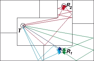

Figure 4. The concept of ray splitting to achieve proper ray density at interactions with objects.
In Figure 4, the orange rays are the original rays. An intersection algorithm determines where interactions may occur. This algorithm ensures that any object larger than the minimum geometrical detail size (see above) will be found, even if it might be between orange rays in the figure. Geometry elements smaller than the maximum ray tube side width and height are not ignored. You can still get interactions at those, but the algorithm cannot guarantee that those are illuminated by at least a single ray.
At each interaction point the area of the ray cross section is computed. If this exceeds the user-set maximum the ray segment is repeated with multiple, split rays, to ensure that the maximum ray tube width and height are not exceeded at the interaction. The original ray (dotted in the Figure 4) is discarded and replaced by the split rays (green rays in Figure 4). The directions of the split rays are computed such that the ray cross sections cover the whole area of the original ray tube’s front.
