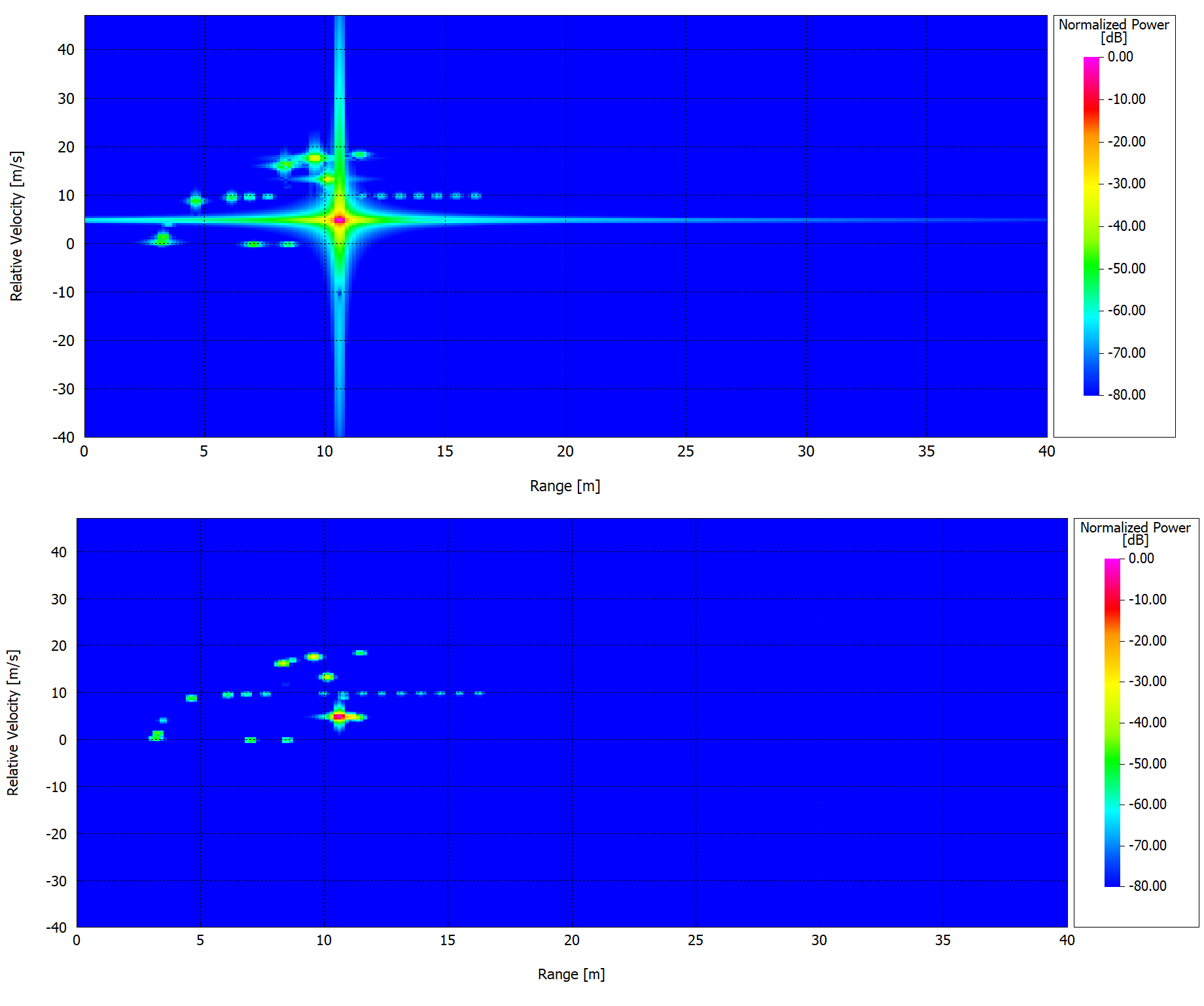

You can specify the desired output and optionally the type of windowing function. Windowing functions are applied in the time domain to suppress the side lobes in the frequency domain. They are also used to detect low signals that could be hidden beneath the side lobe of another target.
- Doppler-Range Heat Map
- Angle-Range Heat Map
- IQ Data.

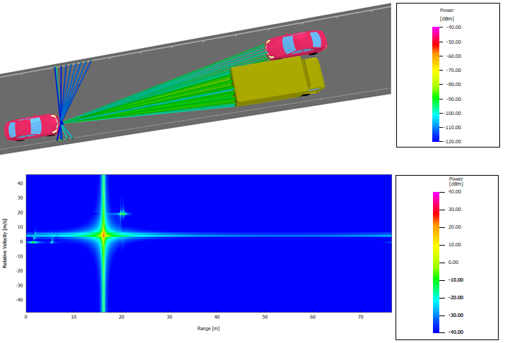

The Doppler-Range Heat Map shows the processed signal as a function of range and relative velocity.
The Angle-Range Heat Map shows the processed signal as a function of range and angle of arrival.
