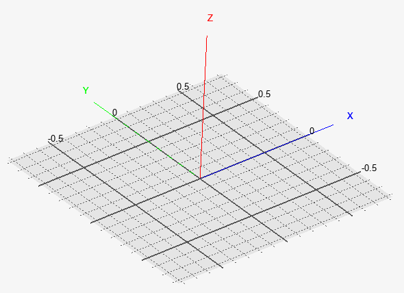

Workplane / Work surface snap options
You can specify how to snap to points on the workplane.
- Auto grid
- The workplane grid size is determined automatically. You can snap to any point on the grid lattice.
- Continuous
- You can snap to any point on the workplane.
- Fixed grid
- The workplane grid is specified by Size. You can snap to any point on the grid lattice.
