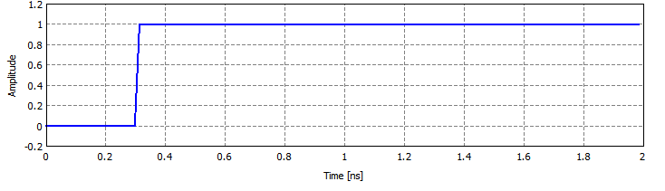

Define Step(t) = 1 for t > 0.3 ns
On the Create time signal dialog, in the f(t) field, add the following to define a step function with a delay of 0.3 ns:

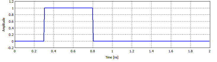

Define a Rectangular Pulse
In the f(t) field, define a rectangular pulse with a duration of 0.5 ns by extending Equation 1 to:

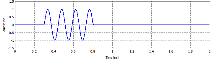

Define a Sine Wave Pulse
- In the f(t) field, define a sine wave pulse with a
delay of 0.3 ns and a duration of 0.5 ns by extending Equation 2
to:Note: Predefined variables are not supported. Use a value of 3.14 instead of pi.
Figure 3. The Signal preview shows the sine wave pulse with a delay of 0.3 ns and a duration of 0.5 ns.

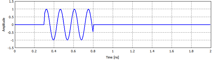

- Add a delay of 0.3 ns to the sine wave by extending Equation 3
to:
Figure 4. The Signal preview shows the final sine wave pulse.
