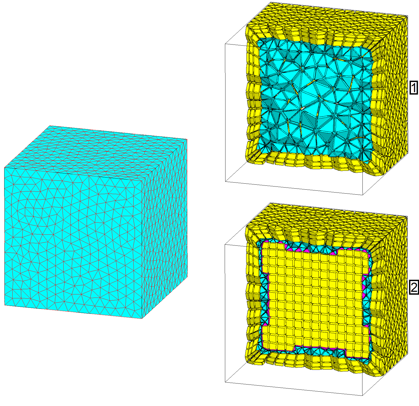

Here is an example of the mesh obtained with Layers mesh generator:
