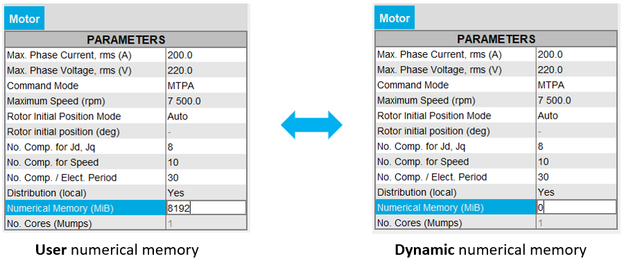

Switch from User to Dynamic numerical memory mode and vice versa inside FeMT
It is now possible to change the numerical memory mode used to run the test inside
FeMT:
- Either switching from User numerical memory mode to Dynamic numerical memory mode by setting the Numerical Memory (MiB) to 0
- Or switching from Dynamic numerical memory mode to
User numerical memory mode by setting the
Numerical Memory (MiB) to a fixed amount of memoryWarning: When switching from Dynamic numerical memory mode to User numerical memory mode, the user must know the numerical memory required to solve the project and therefore set a high enough value.
Note: With previous Flux versions, in order to change the
numerical memory mode, the user had to regenerate the FeMT coupling component in
Flux running in the chosen numerical memory mode.

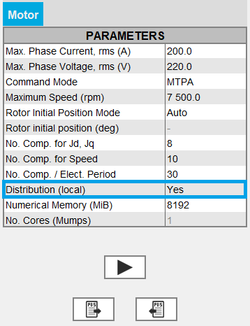

Distributed computing available on Linux
On Linux, it is now possible to run a test by activating the local distribution.
First, you have to make sure that the distribution is properly configured.
See Parametric distribution in Flux (Linux) for more information.
Note: With previous Flux versions, only local distribution on
Windows (via CDE) was possible.

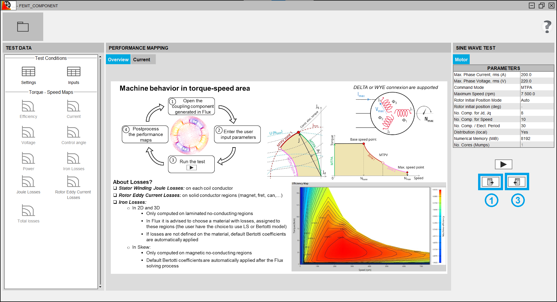

Run tests through PBS (by manual Export / Import)
To save computation time, it is now possible to run tests through PBS.
Once the project is correctly defined, the different steps are:
- In FeMT: Export the required files for PBS
- In PBS: Run the computation through a cluster
- In FeMT: Import the results from PBS
And then postprocess the results as usual.

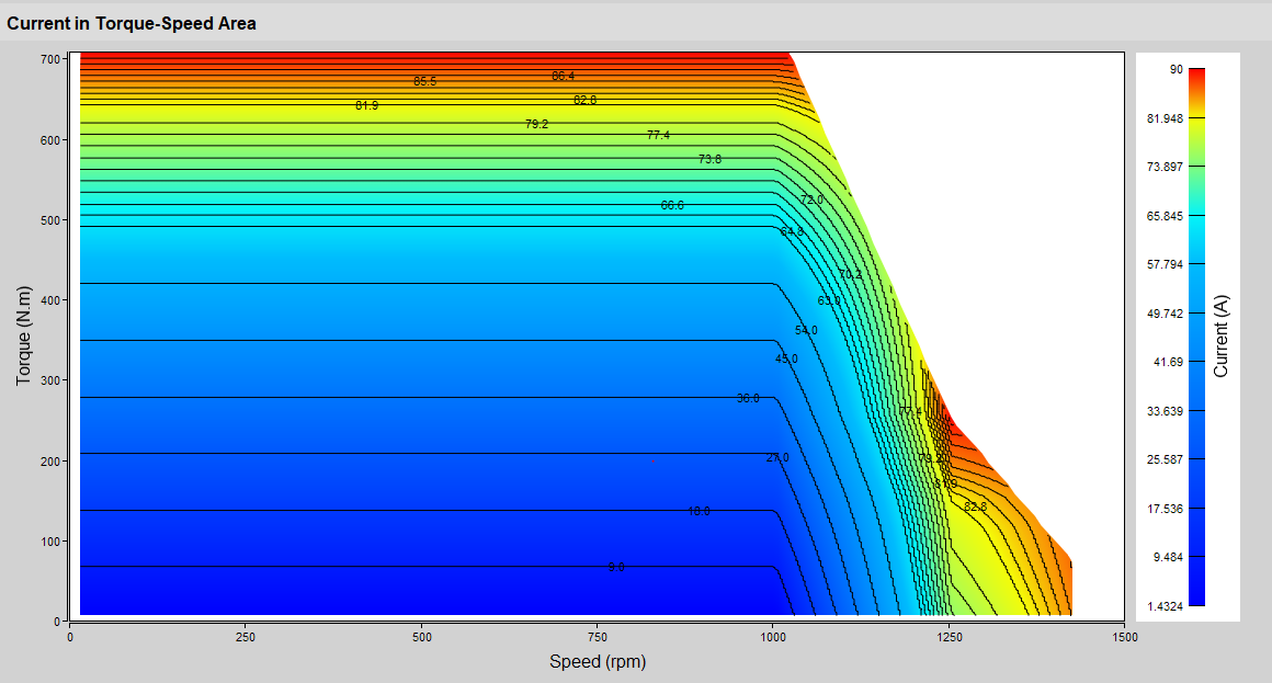

New extrapolation approach for efficiency maps
There is now a new map extrapolation method to obtain correct values near map borders and thus avoid obtaining non-physical values, such as negative Irms values.
