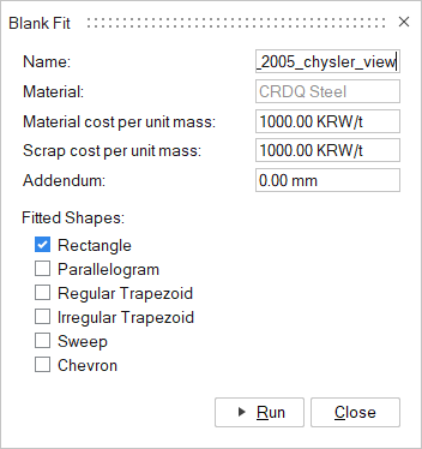

In the Blank Fit dialog, define blank fit settings and
click Run.
- Enter a run name.
- Enter a material and scrap cost per unit mass.
- Enter an addendum (extra material on the periphery of the blank shape for holding the blank in place during the stamping process).
- Select fitted shapes to use when fitting the blank.

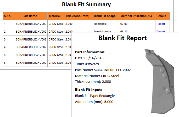

View Blank Fit Summary
View a summary of a blank fit.
From the Feasibility ribbon, Blanks tools, Fit tool group, click the Show Blank Fit tool.
A summary of the blank fit opens in your browser.By default, the most recent blank fit opens. View the results of a different blank fit by selecting a run in the Blank Fit Status or Blank Fit History dialogs.
In the Blank Fit Summary table, click Report to view a detailed blank report for each blank
shape.
- Load the .iges file of the fitted blank shape and flattened outline, that was exported to your run directory, into your session as needed.

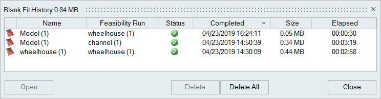

Blank Fit History
View, sort, open, and delete past runs for the current and previous models.
On the Fit icon, click Run
History.
The run history is displayed.
Review the status of the run.
Status Description Note
The run completed successfully.
The run was incomplete. Some but not all of the result types may be available. You should run a new analysis to generate complete results.
The run failed and no meaningful results are available. - To view a run, double-click the row.
- The default directory where the run history is stored can be changed in the Preferences under Run Options.
