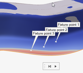

On the model, select fixture points to calculate compensation.
- To select the fixture points manually, click the points you want to use
to create the reference, and then click Create Tracking
System
on the guide bar. You can click a single point or multiple points as needed.

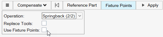

- To calculate compensation automatically using all the points in the
model, click Springback stages
and then deselect the Use Fixture Points checkbox.

On the guide bar, click Apply
The software generates a mesh-based stl file of the compensated die and loads it into the current session. The existing tools are replaced with the compensated tools.
