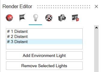

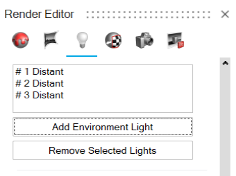

The Render Editor appears.
Select the Environment Lights tab.
To add a light, click Add Environment Light.
The light is added to the list.

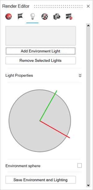

To edit the Light Properties:
To Do this (Render Editor) Do this (Modeling Window) Turn lights on or off Under Light Properties, enable the On switch. Disable the switch to turn the light off. Lights that are on are highlighted yellow in the illustration.
Lights that are off are gray.
- In the Render Editor, turn on Environment sphere.
- In the modeling window, select a light.
- In the microdialog, enable or disable the On switch.

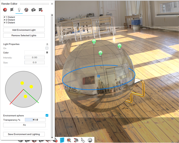

- In the modeling window, a sphere appears with light
bulbs, indicating lights and their positions within
the environment dome. Selected lights are outlined
in yellow.

Reposition a light In the illustration, drag a yellow circle, which represents a light in the scene.
light bulbs, indicating lights and their positions
within the environment dome. Selected lights are
outlined in yellow.
- Drag a light.Note: To reposition multiple lights simultaneously, hold down Ctrl while dragging the lights.

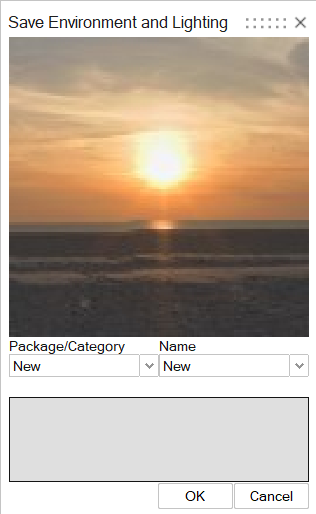

To save the environment and lighting parameters to use as a preset later, click
Save Environment and Lighting.
The Save Environment and Lighting window appears.
