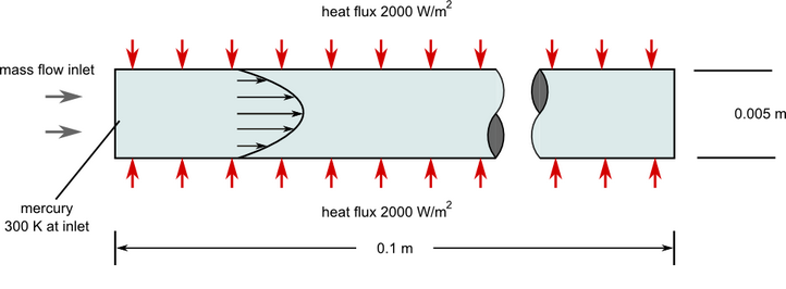

In this application, AcuSolve is used to simulate the flow of mercury through a heated pipe. The AcuSolve results are compared with analytical results for pressure drop as described in White (1991), and with temperature changes as described in Incropera and DeWitt (1981). The close agreement of AcuSolve results with analytical results validates the ability of AcuSolve to model cases with flow and imposed heat flux.
Problem Description

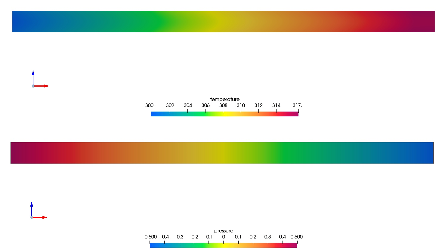

AcuSolve Results
Analytical solution | AcuSolve solution | Percent deviation from analytical | |
Pressure drop (Pa) | 0.991 | 0.994 | 0.303 |
Centerline temperature of flow at outlet (K) | 316.917 | 316.269 | 0.204 |
Summary
The AcuSolve solution compares well with analytical results for flow through a pipe with an imposed heat flux. In this application, the pressure drop in the fluid region is driven by the viscous stresses near the pipe wall. The temperature in the fluid region is influenced by the imposed heat flux on the walls. The values of pressure and temperature that are predicted by AcuSolve are within 0.3 percent of the analytical solution.

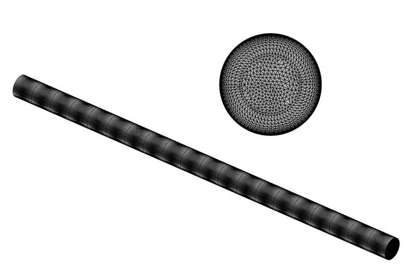

Simulation Settings for Laminar Flow Through a Pipe With Imposed Heat Flux
SimLab database file: <your working directory>\pipe_laminar_heat\pipe_laminar_heat.slb
Global
- Problem Description
- Flow - Steady State
- Temperature equation - Advective Diffusive
- Turbulence equation - Laminar
- Auto Solution Strategy
- Relaxation Factor - 0.2
- Material Model
- Mercury
- Density - 13579.0 kg/m3
- Viscosity - 0.001548 kg/m-sec
Model
- Mercury
- Volume
- Fluid
- Element Set
- Material model - Mercury
- Element Set
- Fluid
- Surfaces
- Inflow
- Simple Boundary Condition - (disabled to allow for periodic conditions to be set)
- Advanced Options
- Integrated Boundary Conditions
- Mass Flux
- Type - Constant
- Constant value - -1.33e-3 kg/sec
- Mass Flux
- Temperature
- Type - Constant
- Constant value - 300.0 K
- Outflow
- Wall
- Type - Wall
- Temperature BC type - Flux
- Heat flux - 2000.0 W/m2
- Inflow
- Periodics
- Periodic 1
- Individual Periodic BCs
- Velocity
- Type - Periodic
- Pressure
- Type - Single Unknown Offset
- Temperature
- Velocity
- Periodic 1
