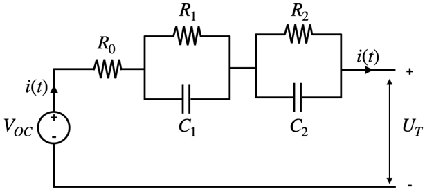

Equivalent Circuit Modeling
Figure 1. 2nd Order Equivalent Circuit Battery Model
In an equivalent circuit model (ECM), the electric behavior, for example, the voltage-current response, is modeled using a phenomenological electric circuit approach. For example, in a 2nd order ECM (see Figure 1), that is, two RC pairs, the governing set of ODEs are given by
U T = V ocv soc , T −  V 1 − V 2 − R 0 soc , T     i t MathType@MTEF@5@5@+= feaahGart1ev3aqatCvAUfeBSjuyZL2yd9gzLbvyNv2CaerbuLwBLn hiov2DGi1BTfMBaeXatLxBI9gBaerbd9wDYLwzYbItLDharqqtubsr 4rNCHbGeaGqiVCI8FfYJH8YrFfeuY=Hhbbf9v8qqaqFr0xc9pk0xbb a9q8WqFfeaY=biLkVcLq=JHqpepeea0=as0Fb9pgeaYRXxe9vr0=vr 0=vqpWqaaeaabiGaciaacaqabeaadaqaaqaaaOqaaabaaaaaaaaape Gaaeyva8aadaWgaaWcbaWdbiaabsfaa8aabeaak8qacqGH9aqpcaqG wbWdamaaBaaaleaapeGaae4BaiaabogacaqG2baapaqabaGcpeWaae Waa8aabaWdbiaabohacaqGVbGaae4yaiaacYcacaqGubaacaGLOaGa ayzkaaGaeyOeI0IaaeiOaiaabAfapaWaaSbaaSqaa8qacaaIXaaapa qabaGcpeGaeyOeI0IaaeOva8aadaWgaaWcbaWdbiaaikdaa8aabeaa k8qacqGHsislcaqGsbWdamaaBaaaleaapeGaaGimaaWdaeqaaOWdbm aabmaapaqaa8qacaqGZbGaae4BaiaabogacaGGSaGaaeivaaGaayjk aiaawMcaaiaaykW7caaMc8UaamyAamaabmaapaqaa8qacaWG0baaca GLOaGaayzkaaaaaa@59F1@
dV 1 d t = − 1 R 1 soc , T C 1 soc , T V 1 − 1 C 1 soc , T i t MathType@MTEF@5@5@+= feaahGart1ev3aqatCvAUfeBSjuyZL2yd9gzLbvyNv2CaerbuLwBLn hiov2DGi1BTfMBaeXatLxBI9gBaerbd9wDYLwzYbItLDharqqtubsr 4rNCHbGeaGqiVCI8FfYJH8YrFfeuY=Hhbbf9v8qqaqFr0xc9pk0xbb a9q8WqFfeaY=biLkVcLq=JHqpepeea0=as0Fb9pgeaYRXxe9vr0=vr 0=vqpWqaaeaabiGaciaacaqabeaadaqaaqaaaOqaaabaaaaaaaaape WaaSaaa8aabaWdbiaabsgacaqGwbWdamaaBaaaleaapeGaaGymaaWd aeqaaaGcbaWdbiaabsgacaWG0baaaiabg2da9iabgkHiTmaalaaapa qaa8qacaaIXaaapaqaa8qacaqGsbWdamaaBaaaleaapeGaaGymaaWd aeqaaOWdbmaabmaapaqaa8qacaqGZbGaae4BaiaabogacaGGSaGaae ivaaGaayjkaiaawMcaaiaaboeapaWaaSbaaSqaa8qacaaIXaaapaqa baGcpeWaaeWaa8aabaWdbiaabohacaqGVbGaae4yaiaacYcacaqGub aacaGLOaGaayzkaaaaaiaabAfapaWaaSbaaSqaa8qacaaIXaaapaqa baGcpeGaeyOeI0YaaSaaa8aabaWdbiaaigdaa8aabaWdbiaaboeapa WaaSbaaSqaa8qacaaIXaaapaqabaGcpeWaaeWaa8aabaWdbiaaboha caqGVbGaae4yaiaacYcacaqGubaacaGLOaGaayzkaaaaaiaadMgada qadaWdaeaapeGaamiDaaGaayjkaiaawMcaaaaa@5D79@
dV 2 d t = − 1 R 2 soc , T C 2 soc , T V 2 − 1 C 2 soc , T i t MathType@MTEF@5@5@+= feaahGart1ev3aqatCvAUfeBSjuyZL2yd9gzLbvyNv2CaerbuLwBLn hiov2DGi1BTfMBaeXatLxBI9gBaerbd9wDYLwzYbItLDharqqtubsr 4rNCHbGeaGqiVCI8FfYJH8YrFfeuY=Hhbbf9v8qqaqFr0xc9pk0xbb a9q8WqFfeaY=biLkVcLq=JHqpepeea0=as0Fb9pgeaYRXxe9vr0=vr 0=vqpWqaaeaabiGaciaacaqabeaadaqaaqaaaOqaaabaaaaaaaaape WaaSaaa8aabaWdbiaabsgacaqGwbWdamaaBaaaleaapeGaaGOmaaWd aeqaaaGcbaWdbiaabsgacaWG0baaaiabg2da9iabgkHiTmaalaaapa qaa8qacaaIXaaapaqaa8qacaqGsbWdamaaBaaaleaapeGaaGOmaaWd aeqaaOWdbmaabmaapaqaa8qacaqGZbGaae4BaiaabogacaGGSaGaae ivaaGaayjkaiaawMcaaiaaboeapaWaaSbaaSqaa8qacaaIYaaapaqa baGcpeWaaeWaa8aabaWdbiaabohacaqGVbGaae4yaiaacYcacaqGub aacaGLOaGaayzkaaaaaiaabAfapaWaaSbaaSqaa8qacaaIYaaapaqa baGcpeGaeyOeI0YaaSaaa8aabaWdbiaaigdaa8aabaWdbiaaboeapa WaaSbaaSqaa8qacaaIYaaapaqabaGcpeWaaeWaa8aabaWdbiaaboha caqGVbGaae4yaiaacYcacaqGubaacaGLOaGaayzkaaaaaiaadMgada qadaWdaeaapeGaamiDaaGaayjkaiaawMcaaaaa@5D7E@
Where U T MathType@MTEF@5@5@+= feaahGart1ev3aqatCvAUfeBSjuyZL2yd9gzLbvyNv2CaerbuLwBLn hiov2DGi1BTfMBaeXatLxBI9gBaerbd9wDYLwzYbItLDharqqtubsr 4rNCHbGeaGqiVCI8FfYJH8YrFfeuY=Hhbbf9v8qqaqFr0xc9pk0xbb a9q8WqFfeaY=biLkVcLq=JHqpepeea0=as0Fb9pgeaYRXxe9vr0=vr 0=vqpWqaaeaabiGaciaacaqabeaadaqaaqaaaOqaaabaaaaaaaaape Gaaeyva8aadaWgaaWcbaWdbiaabsfaa8aabeaaaaa@3816@ is the terminal voltage, soc is the state of charge, T is the temperature, V ocv MathType@MTEF@5@5@+= feaahGart1ev3aqatCvAUfeBSjuyZL2yd9gzLbvyNv2CaerbuLwBLn hiov2DGi1BTfMBaeXatLxBI9gBaerbd9wDYLwzYbItLDharqqtubsr 4rNCHbGeaGqiVCI8FfYJH8YrFfeuY=Hhbbf9v8qqaqFr0xc9pk0xbb a9q8WqFfeaY=biLkVcLq=JHqpepeea0=as0Fb9pgeaYRXxe9vr0=vr 0=vqpWqaaeaabiGaciaacaqabeaadaqaaqaaaOqaaabaaaaaaaaape GaaeOva8aadaWgaaWcbaWdbiaab+gacaqGJbGaaeODaaWdaeqaaaaa @3A11@ is the open circuit voltage, R 0 MathType@MTEF@5@5@+= feaahGart1ev3aqatCvAUfeBSjuyZL2yd9gzLbvyNv2CaerbuLwBLn hiov2DGi1BTfMBaeXatLxBI9gBaerbd9wDYLwzYbItLDharqqtubsr 4rNCHbGeaGqiVCI8FfYJH8YrFfeuY=Hhbbf9v8qqaqFr0xc9pk0xbb a9q8WqFfeaY=biLkVcLq=JHqpepeea0=as0Fb9pgeaYRXxe9vr0=vr 0=vqpWqaaeaabiGaciaacaqabeaadaqaaqaaaOqaaabaaaaaaaaape GaaeOua8aadaWgaaWcbaWdbiaaicdaa8aabeaaaaa@37F6@ is the ohmic resistance, R 1 MathType@MTEF@5@5@+= feaahGart1ev3aqatCvAUfeBSjuyZL2yd9gzLbvyNv2CaerbuLwBLn hiov2DGi1BTfMBaeXatLxBI9gBaerbd9wDYLwzYbItLDharqqtubsr 4rNCHbGeaGqiVCI8FfYJH8YrFfeuY=Hhbbf9v8qqaqFr0xc9pk0xbb a9q8WqFfeaY=biLkVcLq=JHqpepeea0=as0Fb9pgeaYRXxe9vr0=vr 0=vqpWqaaeaabiGaciaacaqabeaadaqaaqaaaOqaaabaaaaaaaaape GaaeOua8aadaWgaaWcbaWdbiaaigdaa8aabeaaaaa@37F7@ and R 2 MathType@MTEF@5@5@+= feaahGart1ev3aqatCvAUfeBSjuyZL2yd9gzLbvyNv2CaerbuLwBLn hiov2DGi1BTfMBaeXatLxBI9gBaerbd9wDYLwzYbItLDharqqtubsr 4rNCHbGeaGqiVCI8FfYJH8YrFfeuY=Hhbbf9v8qqaqFr0xc9pk0xbb a9q8WqFfeaY=biLkVcLq=JHqpepeea0=as0Fb9pgeaYRXxe9vr0=vr 0=vqpWqaaeaabiGaciaacaqabeaadaqaaqaaaOqaaabaaaaaaaaape GaaeOua8aadaWgaaWcbaWdbiaaikdaa8aabeaaaaa@37F8@ are the polarization resistances of the first and second RC pairs respectively, C 1 MathType@MTEF@5@5@+= feaahGart1ev3aqatCvAUfeBSjuyZL2yd9gzLbvyNv2CaerbuLwBLn hiov2DGi1BTfMBaeXatLxBI9gBaerbd9wDYLwzYbItLDharqqtubsr 4rNCHbGeaGqiVCI8FfYJH8YrFfeuY=Hhbbf9v8qqaqFr0xc9pk0xbb a9q8WqFfeaY=biLkVcLq=JHqpepeea0=as0Fb9pgeaYRXxe9vr0=vr 0=vqpWqaaeaabiGaciaacaqabeaadaqaaqaaaOqaaabaaaaaaaaape Gaae4qa8aadaWgaaWcbaWdbiaaigdaa8aabeaaaaa@37E8@ and C 2 MathType@MTEF@5@5@+= feaahGart1ev3aqatCvAUfeBSjuyZL2yd9gzLbvyNv2CaerbuLwBLn hiov2DGi1BTfMBaeXatLxBI9gBaerbd9wDYLwzYbItLDharqqtubsr 4rNCHbGeaGqiVCI8FfYJH8YrFfeuY=Hhbbf9v8qqaqFr0xc9pk0xbb a9q8WqFfeaY=biLkVcLq=JHqpepeea0=as0Fb9pgeaYRXxe9vr0=vr 0=vqpWqaaeaabiGaciaacaqabeaadaqaaqaaaOqaaabaaaaaaaaape Gaae4qa8aadaWgaaWcbaWdbiaaikdaa8aabeaaaaa@37E9@ are the polarization capacitance of the first and second RC pairs respectively, i t MathType@MTEF@5@5@+= feaahGart1ev3aqatCvAUfeBSjuyZL2yd9gzLbvyNv2CaerbuLwBLn hiov2DGi1BTfMBaeXatLxBI9gBaerbd9wDYLwzYbItLDharqqtubsr 4rNCHbGeaGqiVCI8FfYJH8YrFfeuY=Hhbbf9v8qqaqFr0xc9pk0xbb a9q8WqFfeaY=biLkVcLq=JHqpepeea0=as0Fb9pgeaYRXxe9vr0=vr 0=vqpWqaaeaabiGaciaacaqabeaadaqaaqaaaOqaaabaaaaaaaaape GaamyAamaabmaapaqaa8qacaqG0baacaGLOaGaayzkaaaaaa@399A@ is the input current, and t is the time.
The output terminal voltage is therefore dependent on the input current and the ECM parameters ( R 0 ,  R 1 ,   R 2 , C 1 MathType@MTEF@5@5@+= feaahGart1ev3aaatCvAUfeBSjuyZL2yd9gzLbvyNv2CaerbuLwBLn hiov2DGi1BTfMBaeXatLxBI9gBaerbd9wDYLwzYbItLDharqqtubsr 4rNCHbGeaGqiVCI8FfYJH8YrFfeuY=Hhbbf9v8qqaqFr0xc9pk0xbb a9q8WqFfeaY=biLkVcLq=JHqpepeea0=as0Fb9pgeaYRXxe9vr0=vr 0=vqpWqaaeaabiGaciaacaqabeaadaqaaqaaaOqaaabaaaaaaaaape GaaeOua8aadaWgaaWcbaWdbiaaicdaa8aabeaak8qacaGGSaGaaGPa VlaabkfapaWaaSbaaSqaa8qacaaIXaaapaqabaGcpeGaaiilaiaacc kacaaMc8UaaeOua8aadaWgaaWcbaWdbiaaikdaa8aabeaak8qacaGG SaGaae4qa8aadaWgaaWcbaWdbiaaigdaa8aabeaaaaa@443D@ and C 2 MathType@MTEF@5@5@+= feaahGart1ev3aqatCvAUfeBSjuyZL2yd9gzLbvyNv2CaerbuLwBLn hiov2DGi1BTfMBaeXatLxBI9gBaerbd9wDYLwzYbItLDharqqtubsr 4rNCHbGeaGqiVCI8FfYJH8YrFfeuY=Hhbbf9v8qqaqFr0xc9pk0xbb a9q8WqFfeaY=biLkVcLq=JHqpepeea0=as0Fb9pgeaYRXxe9vr0=vr 0=vqpWqaaeaabiGaciaacaqabeaadaqaaqaaaOqaaabaaaaaaaaape Gaae4qa8aadaWgaaWcbaWdbiaaikdaa8aabeaaaaa@37E9@ ) which can depend on both state of charge and temperature.
In AcuSolve, the sign convention dictates that current is positive during discharge. AcuSolve supports three types of ECM models: 1st, 2nd, and 3rd order. The choice of model order depends on the desired dynamics, such as dynamic current conditions. The 2nd and 3rd order models offer enhanced accuracy for pulse-discharge experiments and dynamic current scenarios. Typically, the 2nd order model is considered the optimal choice, striking a balance between accuracy and ease of parameter determination.

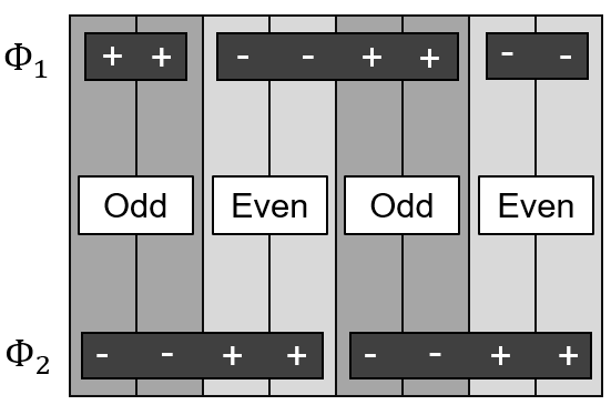

MSMD multi-cell formulation
In a battery module, batteries are connected in a nSmP pattern, for example, 8s6p, where m batteries are connected in parallel and then n of these parallel connected units are connected in serial to form a pack. In the MSMD method, two potential equations are solved for the ϕ 1 MathType@MTEF@5@5@+= feaahGart1ev3aqatCvAUfeBSjuyZL2yd9gzLbvyNv2CaerbuLwBLn hiov2DGi1BTfMBaeXatLxBI9gBaerbd9wDYLwzYbItLDharqqtubsr 4rNCHbGeaGqiVCI8FfYJH8YrFfeuY=Hhbbf9v8qqaqFr0xc9pk0xbb a9q8WqFfeaY=biLkVcLq=JHqpepeea0=as0Fb9pgeaYRXxe9vr0=vr 0=vqpWqaaeaabiGaciaacaqabeaadaqaaqaaaOqaaabaaaaaaaaape Gaeqy1dy2damaaBaaaleaapeGaaGymaaWdaeqaaaaa@38EA@ and ϕ 2 MathType@MTEF@5@5@+= feaahGart1ev3aqatCvAUfeBSjuyZL2yd9gzLbvyNv2CaerbuLwBLn hiov2DGi1BTfMBaeXatLxBI9gBaerbd9wDYLwzYbItLDharqqtubsr 4rNCHbGeaGqiVCI8FfYJH8YrFfeuY=Hhbbf9v8qqaqFr0xc9pk0xbb a9q8WqFfeaY=biLkVcLq=JHqpepeea0=as0Fb9pgeaYRXxe9vr0=vr 0=vqpWqaaeaabiGaciaacaqabeaadaqaaqaaaOqaaabaaaaaaaaape Gaeqy1dy2damaaBaaaleaapeGaaGOmaaWdaeqaaaaa@38EB@ electrical field. Depending on battery connectivity, ϕ 1 MathType@MTEF@5@5@+= feaahGart1ev3aqatCvAUfeBSjuyZL2yd9gzLbvyNv2CaerbuLwBLn hiov2DGi1BTfMBaeXatLxBI9gBaerbd9wDYLwzYbItLDharqqtubsr 4rNCHbGeaGqiVCI8FfYJH8YrFfeuY=Hhbbf9v8qqaqFr0xc9pk0xbb a9q8WqFfeaY=biLkVcLq=JHqpepeea0=as0Fb9pgeaYRXxe9vr0=vr 0=vqpWqaaeaabiGaciaacaqabeaadaqaaqaaaOqaaabaaaaaaaaape Gaeqy1dy2damaaBaaaleaapeGaaGymaaWdaeqaaaaa@38EA@ and ϕ 2 MathType@MTEF@5@5@+= feaahGart1ev3aqatCvAUfeBSjuyZL2yd9gzLbvyNv2CaerbuLwBLn hiov2DGi1BTfMBaeXatLxBI9gBaerbd9wDYLwzYbItLDharqqtubsr 4rNCHbGeaGqiVCI8FfYJH8YrFfeuY=Hhbbf9v8qqaqFr0xc9pk0xbb a9q8WqFfeaY=biLkVcLq=JHqpepeea0=as0Fb9pgeaYRXxe9vr0=vr 0=vqpWqaaeaabiGaciaacaqabeaadaqaaqaaaOqaaabaaaaaaaaape Gaeqy1dy2damaaBaaaleaapeGaaGOmaaWdaeqaaaaa@38EB@ could be the potential from the positive current collector or the negative one. Therefore, in a battery module simulation, the two potential equations are solved with the transfer current density changing sign dependent on the location in the module. The cells are alternating as odd and even stages, see Figure 2. In tabs and busbars, you only solve for one of the fields. In Figure 2, the ϕ 1 MathType@MTEF@5@5@+= feaahGart1ev3aqatCvAUfeBSjuyZL2yd9gzLbvyNv2CaerbuLwBLn hiov2DGi1BTfMBaeXatLxBI9gBaerbd9wDYLwzYbItLDharqqtubsr 4rNCHbGeaGqiVCI8FfYJH8YrFfeuY=Hhbbf9v8qqaqFr0xc9pk0xbb a9q8WqFfeaY=biLkVcLq=JHqpepeea0=as0Fb9pgeaYRXxe9vr0=vr 0=vqpWqaaeaabiGaciaacaqabeaadaqaaqaaaOqaaabaaaaaaaaape Gaeqy1dy2damaaBaaaleaapeGaaGymaaWdaeqaaaaa@38EA@ and ϕ 2 MathType@MTEF@5@5@+= feaahGart1ev3aqatCvAUfeBSjuyZL2yd9gzLbvyNv2CaerbuLwBLn hiov2DGi1BTfMBaeXatLxBI9gBaerbd9wDYLwzYbItLDharqqtubsr 4rNCHbGeaGqiVCI8FfYJH8YrFfeuY=Hhbbf9v8qqaqFr0xc9pk0xbb a9q8WqFfeaY=biLkVcLq=JHqpepeea0=as0Fb9pgeaYRXxe9vr0=vr 0=vqpWqaaeaabiGaciaacaqabeaadaqaaqaaaOqaaabaaaaaaaaape Gaeqy1dy2damaaBaaaleaapeGaaGOmaaWdaeqaaaaa@38EB@ on the left indicates which field was solved in the tabs/busbars in the line. The governing equations for the cell scale become:
∇ σ ∇ ϕ = j MathType@MTEF@5@5@+= feaahGart1ev3aqatCvAUfeBSjuyZL2yd9gzLbvyNv2CaerbuLwBLn hiov2DGi1BTfMBaeXatLxBI9gBaerbd9wDYLwzYbItLDharqqtubsr 4rNCHbGeaGqiVCI8FfYJH8YrFfeuY=Hhbbf9v8qqaqFr0xc9pk0xbb a9q8WqFfeaY=biLkVcLq=JHqpepeea0=as0Fb9pgeaYRXxe9vr0=vr 0=vqpWqaaeaabiGaciaacaqabeaadaqaaqaaaOqaaabaaaaaaaaape Gaey4bIe9aaeWaa8aabaWdbiaabo8acqGHhis0cqaHvpGzaiaawIca caGLPaaacqGH9aqpcaqGQbaaaa@3FC5@
For ϕ 1 MathType@MTEF@5@5@+= feaahGart1ev3aqatCvAUfeBSjuyZL2yd9gzLbvyNv2CaerbuLwBLn hiov2DGi1BTfMBaeXatLxBI9gBaerbd9wDYLwzYbItLDharqqtubsr 4rNCHbGeaGqiVCI8FfYJH8YrFfeuY=Hhbbf9v8qqaqFr0xc9pk0xbb a9q8WqFfeaY=biLkVcLq=JHqpepeea0=as0Fb9pgeaYRXxe9vr0=vr 0=vqpWqaaeaabiGaciaacaqabeaadaqaaqaaaOqaaabaaaaaaaaape Gaeqy1dy2damaaBaaaleaapeGaaGymaaWdaeqaaaaa@38EA@ in an odd stage:
σ = σ +        j = −  I / V MathType@MTEF@5@5@+= feaahGart1ev3aqatCvAUfeBSjuyZL2yd9gzLbvyNv2CaerbuLwBLn hiov2DGi1BTfMBaeXatLxBI9gBaerbd9wDYLwzYbItLDharqqtubsr 4rNCHbGeaGqiVCI8FfYJH8YrFfeuY=Hhbbf9v8qqaqFr0xc9pk0xbb a9q8WqFfeaY=biLkVcLq=JHqpepeea0=as0Fb9pgeaYRXxe9vr0=vr 0=vqpWqaaeaabiGaciaacaqabeaadaqaaqaaaOqaaabaaaaaaaaape Gaae4Wdiabg2da9iaabo8apaWaaSbaaSqaa8qacqGHRaWka8aabeaa k8qacaqGGcGaaeiOaiaabckacaqGGcGaaeiOaiaabckacaqGGcGaae OAaiabg2da9iabgkHiTiaabckacaqGjbGaai4laiaabAfaaaa@494B@
For ϕ 1 MathType@MTEF@5@5@+= feaahGart1ev3aqatCvAUfeBSjuyZL2yd9gzLbvyNv2CaerbuLwBLn hiov2DGi1BTfMBaeXatLxBI9gBaerbd9wDYLwzYbItLDharqqtubsr 4rNCHbGeaGqiVCI8FfYJH8YrFfeuY=Hhbbf9v8qqaqFr0xc9pk0xbb a9q8WqFfeaY=biLkVcLq=JHqpepeea0=as0Fb9pgeaYRXxe9vr0=vr 0=vqpWqaaeaabiGaciaacaqabeaadaqaaqaaaOqaaabaaaaaaaaape Gaeqy1dy2damaaBaaaleaapeGaaGymaaWdaeqaaaaa@38EA@ in an even stage:
σ = σ −                                             j = I / V MathType@MTEF@5@5@+= feaahGart1ev3aqatCvAUfeBSjuyZL2yd9gzLbvyNv2CaerbuLwBLn hiov2DGi1BTfMBaeXatLxBI9gBaerbd9wDYLwzYbItLDharqqtubsr 4rNCHbGeaGqiVCI8FfYJH8YrFfeuY=Hhbbf9v8qqaqFr0xc9pk0xbb a9q8WqFfeaY=biLkVcLq=JHqpepeea0=as0Fb9pgeaYRXxe9vr0=vr 0=vqpWqaaeaabiGaciaacaqabeaadaqaaqaaaOqaaabaaaaaaaaape Gaae4Wdiabg2da9iaabo8apaWaaSbaaSqaa8qacqGHsisla8aabeaa kiaaykW7caaMc8UaaGPaVlaaykW7caaMc8UaaGPaVlaaykW7caaMc8 UaaGPaVlaaykW7caaMc8UaaGPaVlaaykW7caaMc8UaaGPaVlaaykW7 caaMc8UaaGPaVlaaykW7caaMc8UaaGPaVlaaykW7peGaaeOAaiabg2 da9iaabMeacaGGVaGaaeOvaaaa@6143@
For ϕ 2 MathType@MTEF@5@5@+= feaahGart1ev3aqatCvAUfeBSjuyZL2yd9gzLbvyNv2CaerbuLwBLn hiov2DGi1BTfMBaeXatLxBI9gBaerbd9wDYLwzYbItLDharqqtubsr 4rNCHbGeaGqiVCI8FfYJH8YrFfeuY=Hhbbf9v8qqaqFr0xc9pk0xbb a9q8WqFfeaY=biLkVcLq=JHqpepeea0=as0Fb9pgeaYRXxe9vr0=vr 0=vqpWqaaeaabiGaciaacaqabeaadaqaaqaaaOqaaabaaaaaaaaape Gaeqy1dy2damaaBaaaleaapeGaaGOmaaWdaeqaaaaa@38EB@ in an odd stage:
σ = σ −           j =  I / V MathType@MTEF@5@5@+= feaahGart1ev3aqatCvAUfeBSjuyZL2yd9gzLbvyNv2CaerbuLwBLn hiov2DGi1BTfMBaeXatLxBI9gBaerbd9wDYLwzYbItLDharqqtubsr 4rNCHbGeaGqiVCI8FfYJH8YrFfeuY=Hhbbf9v8qqaqFr0xc9pk0xbb a9q8WqFfeaY=biLkVcLq=JHqpepeea0=as0Fb9pgeaYRXxe9vr0=vr 0=vqpWqaaeaabiGaciaacaqabeaadaqaaqaaaOqaaabaaaaaaaaape Gaae4Wdiabg2da9iaabo8apaWaaSbaaSqaa8qacqGHsisla8aabeaa k8qacaqGGcGaaeiOaiaabckacaqGGcGaaeiOaiaabckacaqGGcGaae iOaiaabckacaqGGcGaaeOAaiabg2da9iaabckacaqGjbGaai4laiaa bAfaaaa@4BD2@
For ϕ 2 MathType@MTEF@5@5@+= feaahGart1ev3aqatCvAUfeBSjuyZL2yd9gzLbvyNv2CaerbuLwBLn hiov2DGi1BTfMBaeXatLxBI9gBaerbd9wDYLwzYbItLDharqqtubsr 4rNCHbGeaGqiVCI8FfYJH8YrFfeuY=Hhbbf9v8qqaqFr0xc9pk0xbb a9q8WqFfeaY=biLkVcLq=JHqpepeea0=as0Fb9pgeaYRXxe9vr0=vr 0=vqpWqaaeaabiGaciaacaqabeaadaqaaqaaaOqaaabaaaaaaaaape Gaeqy1dy2damaaBaaaleaapeGaaGOmaaWdaeqaaaaa@38EB@ in an even stage:
σ= σ +                    j=−I/V MathType@MTEF@5@5@+= feaahGart1ev3aqatCvAUfeBSjuyZL2yd9gzLbvyNv2CaerbuLwBLn hiov2DGi1BTfMBaeXatLxBI9gBaerbd9wDYLwzYbItLDharqqtubsr 4rNCHbGeaGqiVCI8FfYJH8YrFfeuY=Hhbbf9v8qqaqFr0xc9pk0xbb a9q8WqFfeaY=biLkVcLq=JHqpepeea0=as0Fb9pgeaYRXxe9vr0=vr 0=vqpWqaaeaabiGaciaacaqabeaadaqaaqaaaOqaaabaaaaaaaaape Gaae4Wdiabg2da9iaabo8apaWaaSbaaSqaa8qacqGHRaWka8aabeaa kiaaykW7caaMc8UaaGPaVlaaykW7caaMc8UaaGPaVlaaykW7caaMc8 UaaGPaVlaaykW7caaMc8UaaGPaVlaaykW7caaMc8UaaGPaVlaaykW7 caaMc8UaaGPaVlaaykW7peGaaeOAaiabg2da9iabgkHiTiaabMeaca GGVaGaaeOvaaaa@5D84@
Figure 2. Odd and Even Stages for Connected Cells
