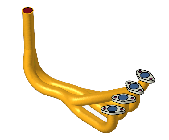

- Select the exhaust volume.
In the microdialog, select Stainless steel
(304) from the drop-down.

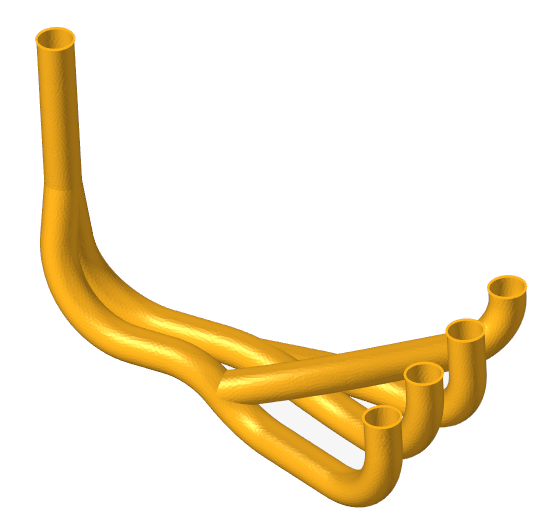

- Select the air volume.
In the microdialog, select Air
from the drop-down.

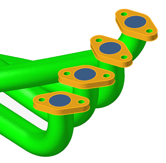

Select the wall flanges.
Figure 18.
Note: Make sure you select the bottom and side surfaces of the flanges. In total, 12 surfaces should be selected. -

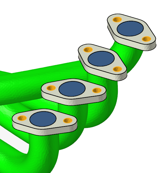

Select the flange bolts.
Figure 20.
- In the microdialog, click the Temperature tab and assign the same parameters as the wall flanges.

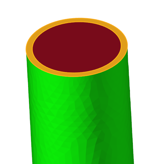

Select the outlet end.
Figure 21.
- In the microdialog, click the Temperature tab and assign the same parameters as the wall flanges and bolts.

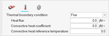

Check that default values are assigned to the thermal boundary
conditions.
