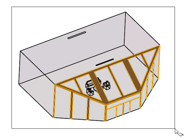

In the modeling window, select the four surfaces
highlighted in the image below.
Figure 15.
- In the microdialog, set the Layer thickness to 0.025 and the Material to Aluminum.
On the guide bar, verify that the number of Parent
Surfaces selected is 4 then click
to execute the
command.

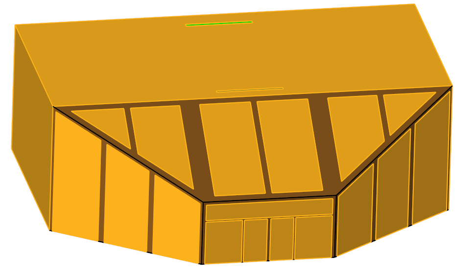

In the modeling window, click the inlet surface
highlighted in the figure below.
Figure 17.
In the microdialog, enter the values shown below.
Figure 18.
Click
on the guide bar to execute
the changes.

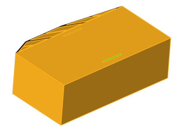

Select the surface highlighted in the figure below then click
on the guide bar.

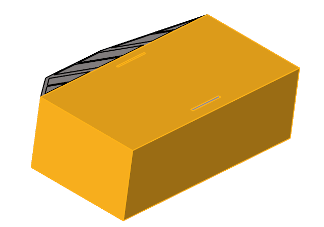

Select all three wall surfaces of the atrium, the roof, and the front glass
walls.
Figure 22. Front-Side of the Model
Figure 23. Back-Side of the Model
In total, 21 surfaces should be selected.

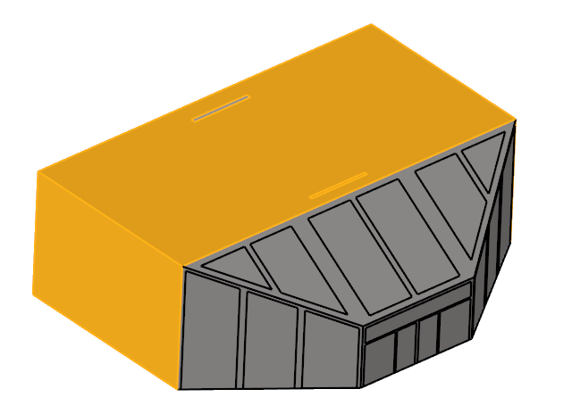

Select the three wall surfaces, the inlet, and the roof surface, as highlighted
in the figures below.
Figure 37. Front-Side of the Model
Figure 38. Back-Side of the Model
In the microdialog, set the Solar radiation model to
BB out then click
on the guide bar.

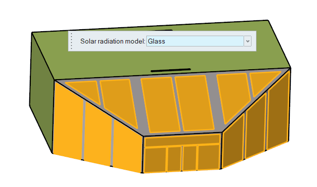

Select all the glass surfaces shown in the figure below, assign the
Glass model to them, then click
on the guide bar.

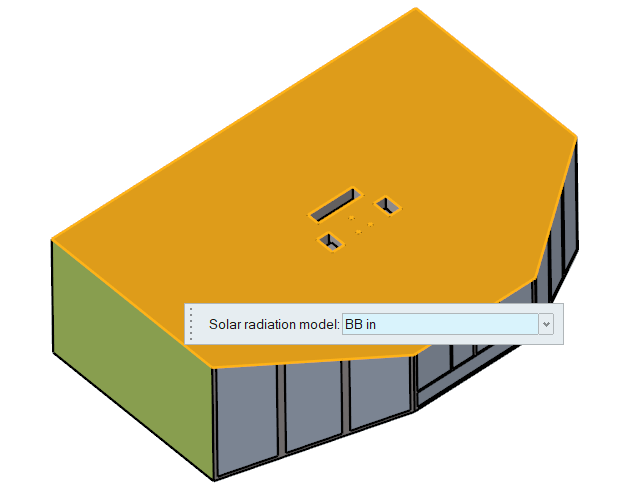

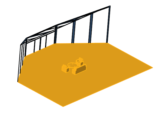

Rotate the model and select the floor surface. In the microdialog, assign the BB in model
then click
on the guide bar.

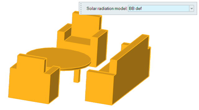

Select the surfaces of the couch, table, and chairs, assign the BB
def model to them, then click
on the guide bar.
