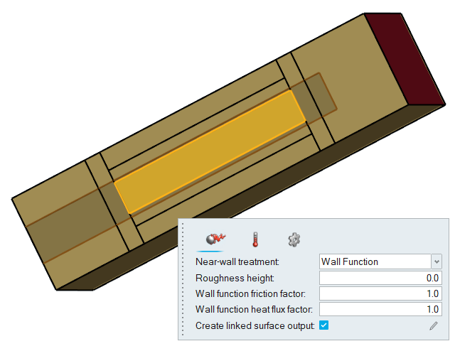

Click the No Slip tool.
Figure 16.
Select the face highlighted in the figure below to create the Heated_wall
face.

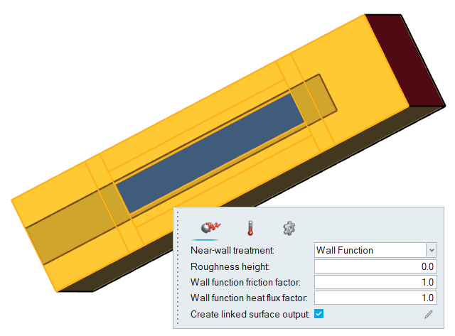

Figure 19.
Select the 8 highlighted surfaces shown in the figure below to create the
Bottom_wall faces then click
on the guide bar.
Figure 20.
