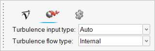

- In the microdialog, click the Turbulence tab.
- Set the Turbulence input type to Auto.
Set the Turbulence flow type to Internal.
Figure 9.

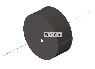

Click the Rotation tool.
Figure 15.
- Select the solid in the modeling window.
- On the guide bar, click Axis.
Define the axis of rotation.
Figure 17.
