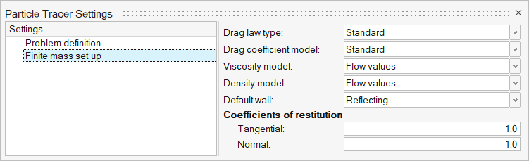

- Click Problem definition and set the Particle type to Finite Mass.
- For the AcuSolve working directory, select the ACUSIM.DIR (flow results) folder in your problem directory.
- Make sure the Flow field type set to Static.
Disable Mesh motion if it not disabled already.
Figure 39.
Click Finite mass set-up and leave all the parameters as
shown below.
Figure 40.

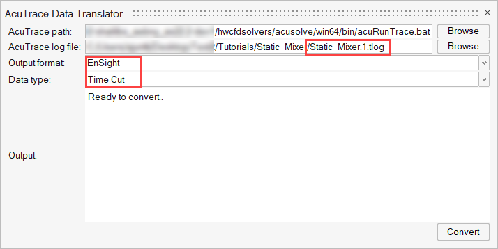

Click the Convert tool.
Figure 55.
The AcuTrace Data Translator window opens. - Browse to the location where the AcuTrace log file (*.tlog) is located.
- Set the Output format to Ensight.
Set Data type to Time Cut.
Figure 56.

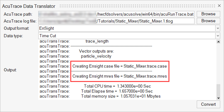

Click Convert.
Once the conversion is successful, it generates two Ensight result files.
Figure 57.
