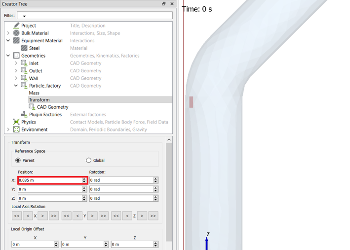

Under Particle_factory, click Transform. Set the
X-Position to 0.035 m
Figure 30.
Note: Set the Opacity value to 0.2 to see the transformed surface location inside the pipe geometry.This is done to make sure that the particles are generated inside the fluid domain.

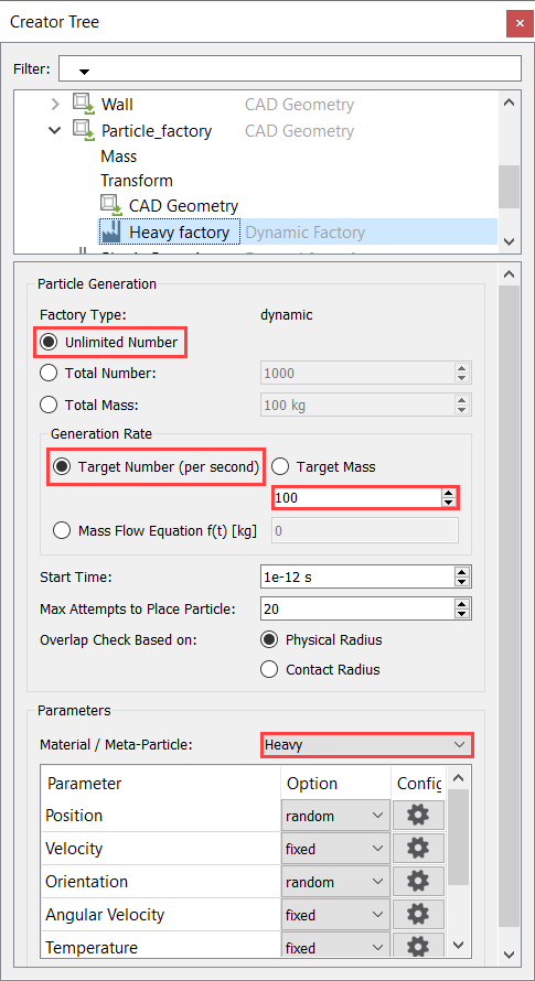

- In the Creator Tree, right-click on Particle_factory and select Add Factory.
- Rename the new factory to Heavy factory.
Set the particle generation parameters as shown in the figure below.
Figure 36.
Click
besides Velocity, set the
X-velocity to 1 m/s, then click
OK.
Click
besides Temperature, set the value to
363 K, then click OK.

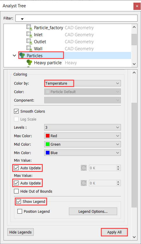

- In the Analyst Tree, click Particles.
- Set the coloring to Temperature.
- Activate the Auto Update checkboxes for both the Min and Max Value.
- Activate the Show Legend checkbox.
Click Apply All.
Figure 53.
