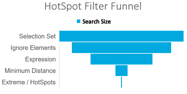

Using the hotspot search, you can find hotspots in a model based on filtering rules and
a logical combination of such rules.
Data filtering rules for Selection set, ignoring specific element types, threshold
values, maintaining a minimum distance between hotspots and limiting the search to a
number of extreme top or bottom values.
The rules can be used in sequence using a keyword THEN and also you can get a combined
effect using boolean logic based on AND, OR and brackets.

Figure 2. Hotspot Search Criteria
Figure 3. Recommended approach
