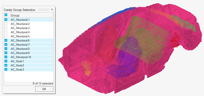

  4. Select structural components that surround the desired cavity. Select all of the components that enclose the air spaces. You can create meshes for multiple air spaces simultaneously, depending on which components you initially select.
  5. Select seat components to select the solid bodies representing the seat's acoustic cavity meshing, takes seating into account, and generates a separate volume mesh for each seat (bench seats are correctly treated as a single assembly, not broken up into individual seats based on the number of humans who could sit on them). This distinguishes the seats from the mesh that represents the air space.

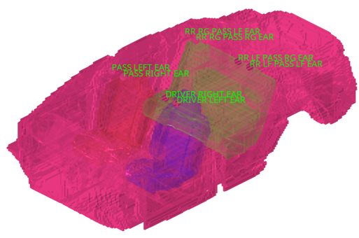

  6. Click Preview to see the preview of the mesh.
    Voxel-based preview of the mesh appears in the modeling window along with the list box. The entries in the list box allows you to show/hide/isolate the preview mesh. Select the preview mesh for which final acoustic cavity mesh needs to be created.
    Figure 4. Simple Preview Mesh

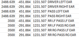

  7. Optional: Select the response points from the .csv file.
    Response points are defined in terms of nodal coordinates and tag label.
    Figure 5.
    Figure 6. Simple Preview Mesh with Response Points Information

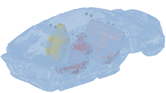

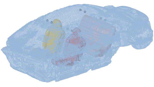

  8. Create final acoustic mesh.
    Figure 7. Final Acoustic Cavity Mesh

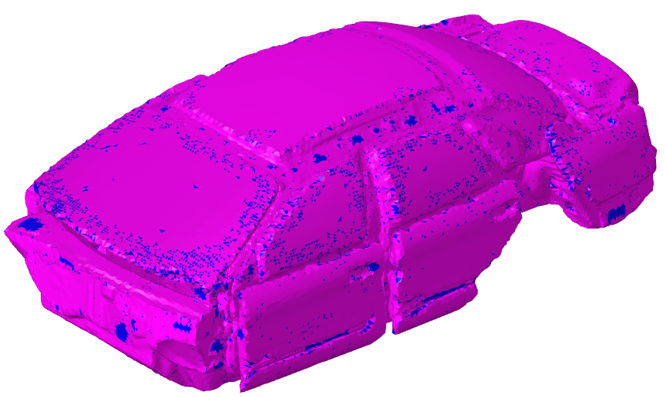

    This shows the coupling between structure and cavity indicating transfer of energy from structure to cavity. The pink color indicates properly coupled regions and blue color indicates uncoupled regions.
    Figure 9. Fluid-Structure Interface

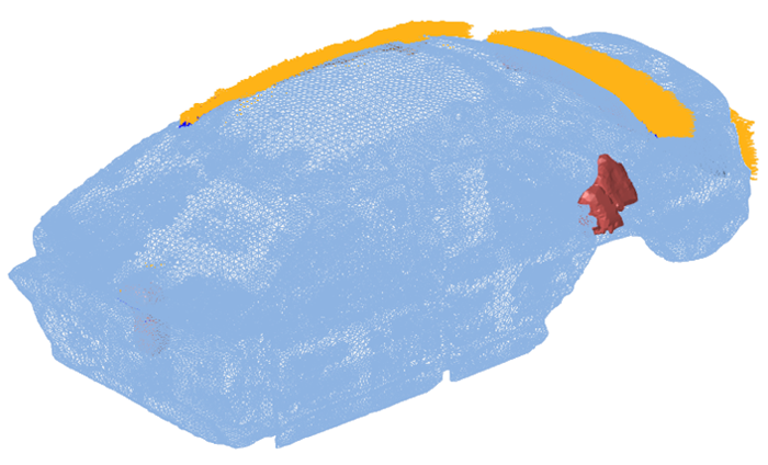

    This shows the coupling between main and secondary components with MPC equations.
    Figure 11. Fluid-Fluid Interface with MPC Equations
