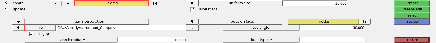

                Average pressure distribution over the surface of canard is exported as text file from AcuFieldView. This file contains the location and value of the pressure. The AerodynamicLoad_0deg.csv, AerodynamicLoad_Negative10deg.csv, and AerodynamicLoad_Positive10deg.csv files contain the pressure distribution information for 0deg, -10 deg, and 10 deg of canard orientation respectively.Add load collectors for three cases:
                Browse to the Pressure load panel.
                Set the pressure load type to linear
                    interpolation.
                Now you can select elements on which pressure loads are applied and a CSV file for pressure load info.Figure 11.
                Create pressure loads on a canard surface.
                Pressure loads for each position are created under their respective load collectors so you can scale them in MotionSolve with respect to the canard position.

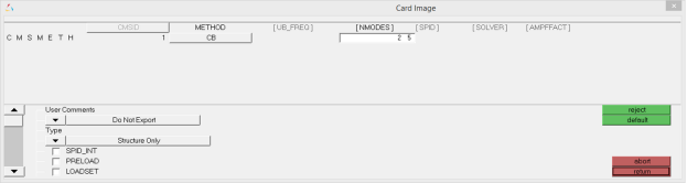

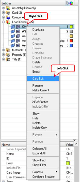

                Specify load sets for CMS method.
                Three load cases modeled in previous step represent nodal forces. These nodal forces are transformed as modal forces using CMS method. In this step you modify the existing CMSMETH card image to include three load sets.
                Specify load sets for CMSMETH.

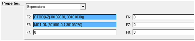

- An expression type Output request to measure the “ForeCanard angular
                            position” and “Piston force along its axis”. The Fore canard angular
                            position is measured from the
                                RevJnt_TorqueArm_Gnd joint rotation
                            angle using the expression
                            `RTOD({j_4.AZ})`. The Piston force is
                            measured from the Piston Motion using the expression
                                `MOTION({mot_0.idstring},{0},{4},{j_2.i.idstring})`.

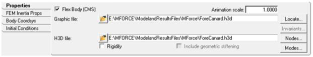

                Switch the rigid fore canard to a flexible body.

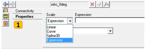

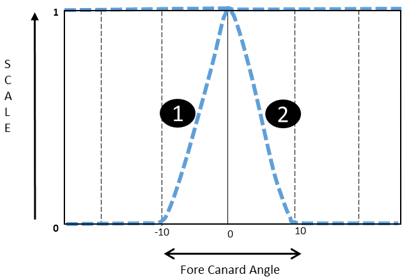

                The aero-dynamic loads are estimated at three distinct positions of canard namely - 10 deg, 0deg, 10deg. Assume each pressure load to linearly vary in interval ±10deg on a 0 to 1 scale. This variation of the aero-dynamic loads is achieved by scaling Modal Forces with respect to canard angle using an expression.
                Configure the ModalForce panel.
