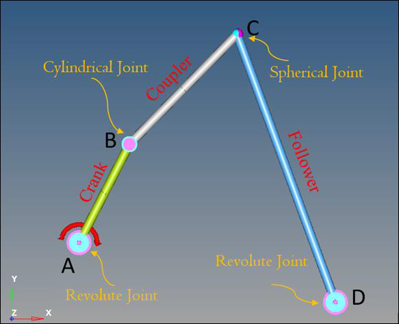

In this tutorial, the locations of the joints of a 4-bar mechanism are
optimized to obtain a desired motion of the coupler. MotionSolve's DSA (Design Sensitivity Analysis)
capability is used to calculate sensitivities.Figure 1. 4 bar model with joint types The entire model is parameterized in terms of these four design
points: A, B, C and D. Since the model operates in 2D space (X-Y plane),
this leads to 8 Design Variables. The initial design is listed as in Table 1:

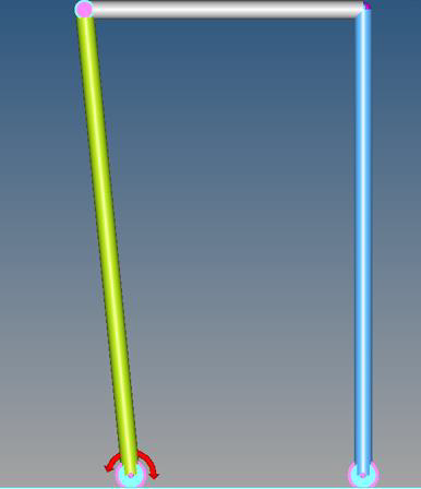

Return to the Design Variables page and change the
nominal value, upper and lower bounds as shown in Figure 15:
Figure 15. Value of Design Variables
The four bar mechanism should look like the example in Figure 16: Figure 16. Four bar mechanism after changing the value of Dvs

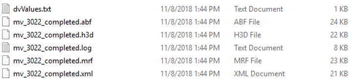

Figure 18. Subfolders that contain the infeasible designsWhen the optimizer recovers from an infeasible design, an additional
folder ‘Infeasible Points’ is created; each subfolder
contains the following information:
dvValues.txt: Value of design variables
4bar_opt_for_recover.abf: MotionSolve output
file
4bar_opt_for_recover.h3d: Animation file (provided only when
available)
4bar_opt_for_recover.log: MotionSolve log
file
4bar_opt_for_recover.mrf: MotionSolve output
file
4bar_opt_for_recover.xml: MotionSolve xml
input file

You will load this h3d file in HyperView and see
what is going wrong.
Load 4bar_opt_for_recover.h3d in folder
Infeasible Point 1 -- iter-2.
You can see that the system enters a lock-up position before the solver
crashes: Figure 20.
Check the result.
