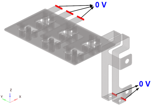

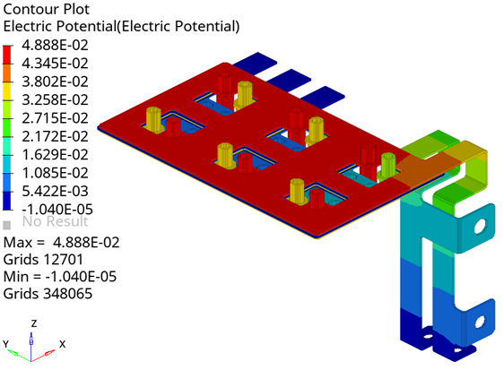

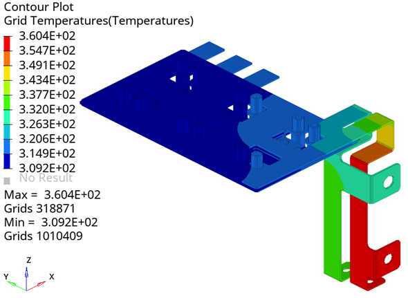

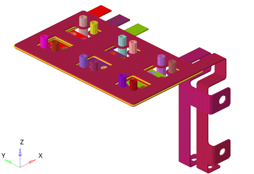

A visual example of modeling Joule heating in a Busbar system.
Busbars are commonly used in many applications to provide power to various electronic boxes.
The model consists is an electrical system with five circuits. The circuits are separated from each other using a thin di-electric layer.
An initial temperature of 20 degrees Celsius is applied to all the bodies.
