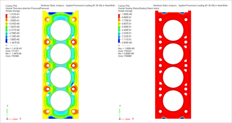

The capacity of gasket sealing mainly depends upon the pre-stressing of the bolts, which are the source of the maximum external loading on the inner structure of the cylinder head.
The location of the weakest contact pressure on the raised portion of the gasket can be transferred as a result of the effect of thermal stress or strain, which may cause the increase in pressure and escaping of the gas.

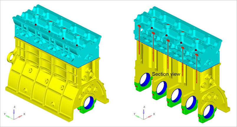

Based on the above use case, Nonlinear Static Analysis is demonstrated for the Altair inline-four engine block model, as shown in Figure 1. The key features such as 3D pretension bolts, gasket material
modeling, friction contact and bore deformations are highlighted.

- FE Model
- Element Types
- CHEXA

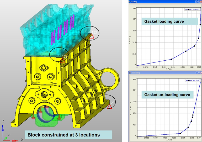

The linear material properties are:
- MAT1
- Young’s Modulus
- 21500 MPa
- Poisson's Ratio
- 0.3
- MGASK
- Direct Tensile Modulus
- 0.001
- Transverse Shear Modulus
- 12000

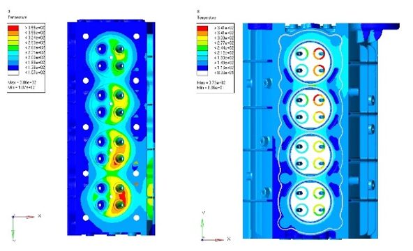

- Thermal Loadings
- In the case of thermal loadings, the nodal temperatures resulting from the prescribed
thermal analysis are assigned to all corresponding nodes of the FEM model of the second
cylinder head in order to calculate the thermal stress/strain of the cylinder head
structure.

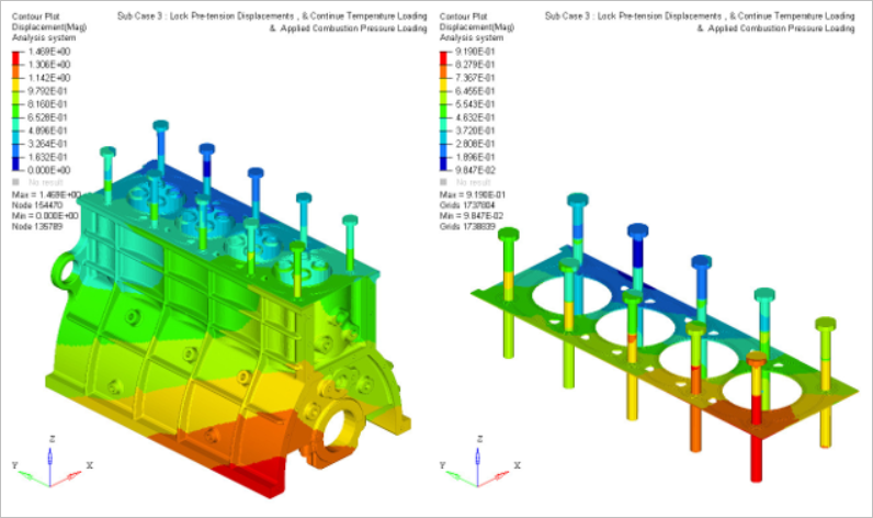

The nonlinear static
analysis material properties are:

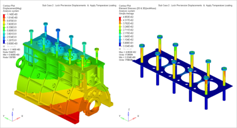

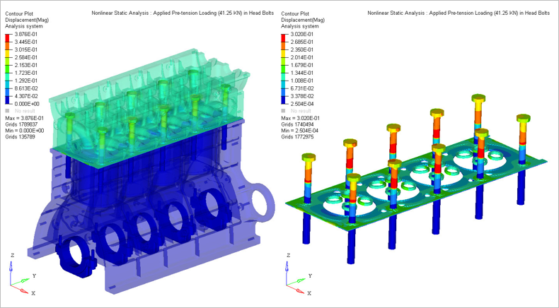

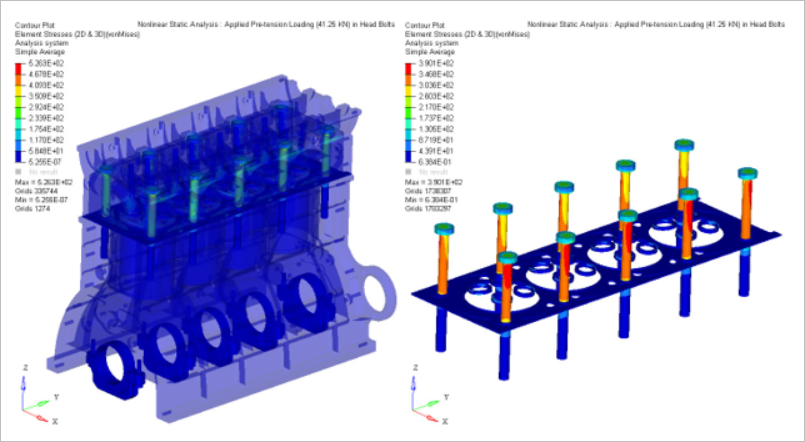

- Case 1
- Assembly Loadings
- Applied pretension loading (41.25 KN) in head bolts

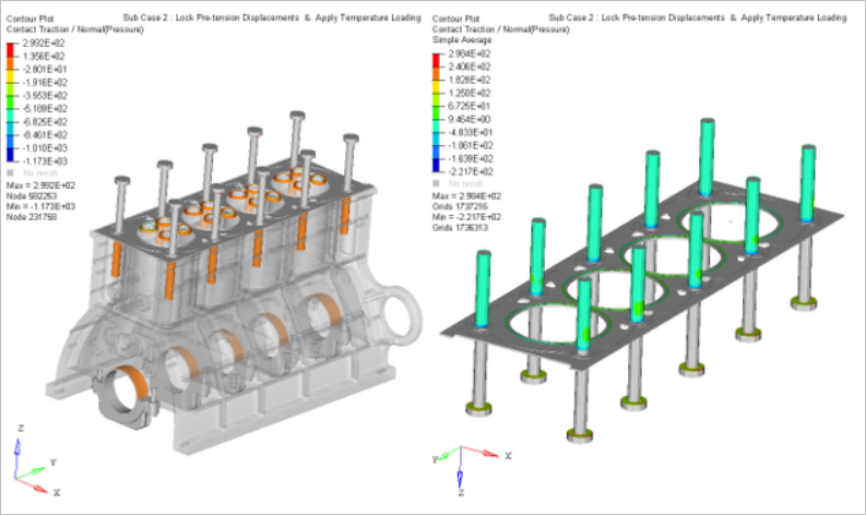

- Case 2
- Thermal Loadings
- Lock pretension displacements

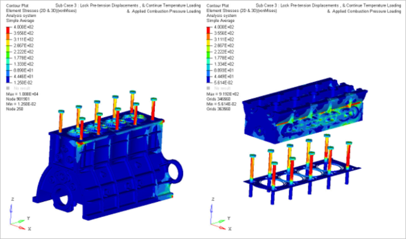

- Case 3
- Gas Pressure
Results
