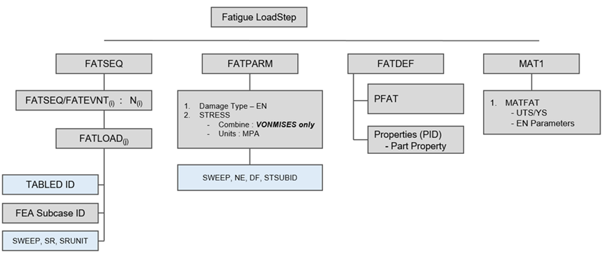

The outline of the Fatigue Analysis setup in this tutorial is shown in the Figure 2 block diagram.
Figure 2. Fatigue Setup Sine Sweep - EN Damage

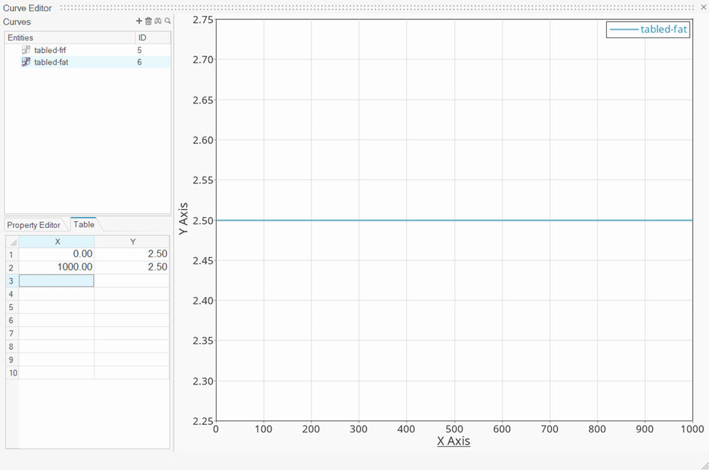

Define TABLED1
  1. In the Model Browser, right-click and select Create > Curve.
    A default Curve editor window opens.
  2. For Name, enter tabled-fat.
  3. Enter the following magnitudes for (x,y):
    1. (x1, y1) = (0.0, 2.5)
    2. (x2, y2) = (10000.0, 2.5)
  4. Close the Curve editor window.
  5. In the Model Browser, under Curves, select tabled-fat.
  6. For Card Image, select TABLED1 from the drop-down menu.
  7. Verify the XAXIS and YAXIS interpolation scheme is set to LINEAR.
    Figure 5. TABLED1 Card

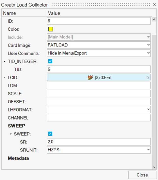

Define FATLOAD
  1. In the Model Browser, right-click and select Create > Load Collector.
  2. For Name, enter fatload-fat.
  3. For Card Image, select FATLOAD from the drop-down menu.
  4. Select the TID_INTEGER check box.
  5. Set the value of TID as the Curve ID of tabled-fat (in this tutorial, tabled-fat ID = 6).
  6. For LCID (load case ID), select 03_frf from the list of load steps.
    This is the Frequency Response Analysis load step.
  7. Select the Sweep check box.
  8. Define the sine sweep parameters as:
    1. SR (sweep rate) = 2.0
    2. SRUNIT (sweep rate unit) = HZPS
    Figure 6. FATLOAD with LCID and SWEEP Parameters
  9. Click Close.

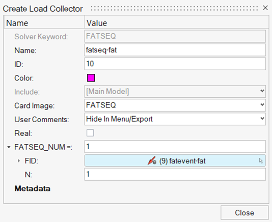

Define FATSEQ
  2. For Name, enter fatseq-fat.
  3. For Card Image, select FATSEQ from the drop-down menu.
  4. For FATSEQ_NUM, enter 1 as we have 1 FATEVENT created.
  5. For FID (Fatigue Event Definition), select fatevent-fat from the list of load collectors.
  6. For N, enter 1.
    Figure 7. FATSEQ Showing the fatevent-fat Created
  7. Click Close.

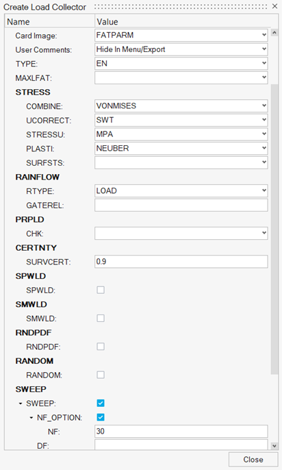

Define Fatigue Parameters
  2. For Name, enter fatparm-fat.
  3. For Card Image, select FATPARM from the drop-down menu.
  4. Under STRESS, for COMBINE select VONMISES.
  5. For STRESSU to MPA.
  6. Verify TYPE is set to EN.
  7. Under CERTNTY, for SURVCERT enter 0.9.
  8. Select the SWEEP check box.
  9. Select the NF_OPTION check box and enter 30 in the text box.
    Figure 8. FATPARM with SWEEP Parameters
  10. Click Close.

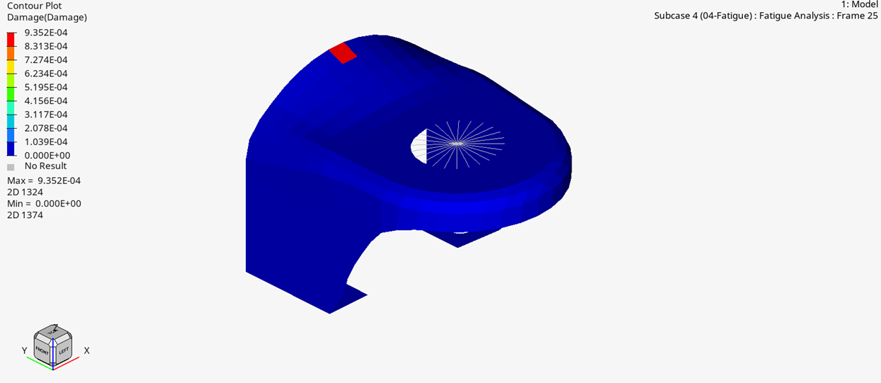

View the Results
  1. When the analysis is finished, click HyperView to launch the results.
  2. In the Results tab, select Subcase 4 (04-Fatigue) from the Subcase field.
  3. Select Contour.
  4. For Result type, select Damage.
  5. Click Apply.
    Figure 10. Damage Contour Plot
