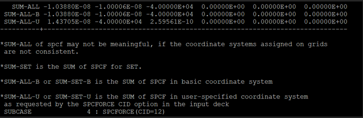

In addition to the above values:
Comments
The I/O Option Previously Supported Results controls
the frequency of output for analytical results during an optimization.
SUM-ALL-B is the sum of SPCF results in
the basic coordinate system, and SUM-ALL-U is the sum of SPCF results in the
user-defined coordinate system via SPCFORCE(CID=ID), where
ID is the user-defined coordinate system (via for
example, CORD1R). Figure 1 showcases how the output at
the end of the .spcf file looks for the case where such
user-defined coordinate system based output is requested using
SPCFORCE(CID=12).Figure 1.
