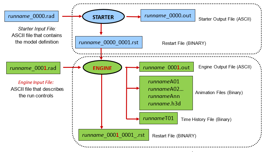

Solution Process
There are two parts to the Radioss simulation, the Starter and Engine. The Starter is an input data check and must successfully complete without errors before the simulation can be completed in the Engine.
Starter and Engine
The Radioss Starter takes as input the model or commonly called Starter input file runname_0000.rad and creates the Starter output file runname_0000.out. The Radioss Starter is responsible for checking the model consistency and reporting any errors or warnings in the output file. If there are no errors in the model, the Radioss Starter creates initial restart file(s), runname_0000_CPU#.rst. There is one restart file created for each SPMD MPI domain requested for the solution.

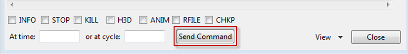

The optional control file is used to get information about a currently running analysis.
While a simulation is running, it can be very useful to find out more information than is printed in the Engine output file. This can be done using a Radioss control file which has the same prefix name as the current Engine input file but ends in *.ctl. If the current running Engine file is named TensileTest_0001.rad, the control file should be named TensileTest_0001.ctl.
- Retrieve the current state of the simulation including current simulation time, time step, cycle, energy information, and estimated remaining time
- Stop the computation immediately, or at a specified time or cycle number
- Create an animation immediately, or at a specified time or cycle number
If the Compute Console (ACC) is not being used, the control file can be created using a text editor and saved in the directory where Radioss is writing the Engine output file.

Define and Run Multiple Engine Input Files
As mentioned above, the first Engine file is named runname_0001.rad. When creating a second Engine file, the number is increased by 1 for the next Engine file to a maximum of 9999 Engine files. So, the second Engine file would be named runname_0002.rad. To avoid a warning message, the Engine file number should also match the Run Number listed in the keyword, /RUN.
/RUN/TensileTest/1
5.0
