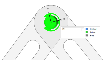

Select a joint to edit it.
The microdialog appears.
Joint editing options are listed below:To Do this Notes Change the joint's type In the microdialog, select a joint type from the dropdown menu. The joint can be changed to any type regardless of the type of joint Inspire creates based on detected geometry. Translate or rotate the joint In the microdialog, select the Move tool
Drag the white arrows, or enter a value for X, Y, or Z to translate or rotate the joint.
Reset the joint to its original location and orientation In the microdialog, select the Reset

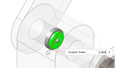

button. The joint type will not reset. Resize the joint - While in the Joints edit context, click on the joint.
- Left-click, hold, and drag the white arrow,or enter a value for the Graphic Scale.
- Click in clear space to exit graphic sizing and enter normal editing mode.
Resize multiple joints - Hold the Ctrl key
- Select multiple joints.
- Enter a value in the Graphic
Scale microdialog.
The joints will be simoltaneosly resized.

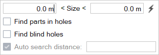

Find Options
Click the
menu on the guide bar to filter the search results.
- Find Larger/Smaller/Similar
- Find holes that are smaller, larger, or similar (±5%) in size to selected holes.
- Options
- Click to specify options for the find operation.
- Size
- Specify a minimum and maximum size range for the hole diameter. This option applies to
Aligned Holes and Single Holes. Click the
icon to
reset the default value. - Find Parts in Holes
- If enabled, the Joints tool automatically finds existing geometry in holes, hides it, and deactivates it so that it is not included in analysis or optimization calculations. Deselect Find Parts in Holes to disable this behavior, in which case you will need to delete the existing geometry manually.
- Find Blind Holes
- Enable to automatically detect blind holes during the find operation.
- Auto Search Distance
- This is a global search threshold that uses default tolerances to find locations where joints can be created. When the checkbox is enabled, it is calculated automatically. To change the search distance, deselect the checkbox and enter a value in the text box. Any joints with a minimum gap less than the entered search distance will be found. (The minimum gap is the exact minimum distance between the two parts.)

- Joint Type
- Joints are available in a variety of types such as Pin, Hinge, or Ball and Socket. The most likely joint type, which is based on the detected features, will be automatically selected. The joint type can then be changed to any type you would like.
- Joint State
- Each joint has a state which can be set to Locked, Active, or Free.
- Select Locked to prevent movement in the joint.
- Select Free if you want the mechanism to behave as if the joint is not there.
