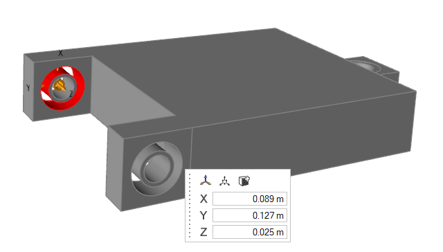

Click Create the Bushing
In the microdialog, you have the following options:
Option Description Align to Global Axes
Align to the global axes. Move
Translate or rotate using the Move tool. Add/Remove
Add/remove faces from the selected bushings. Set Origin X Set the origin coordinate in the X direction. Set Origin Y Set the origin coordinate in the Y direction. Set Origin Z Set the origin coordinate in the Z direction. - To create more bushings, repeat Steps 2–7.
