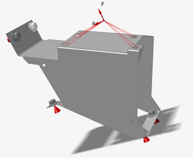

Note that it has two load cases, five parts, a concentrated mass, and six mounting locations.

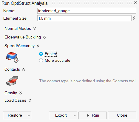

On the Structure ribbon, click the Run OptiStruct
Analysis
button in the Analyze tool group to open the Run OptiStruct Analysis window.
Tip: To find and open a tool, press Ctrl+F. For more information, see Find and Search for Tools. -
Run the analysis using the following settings:
- Change the Element size to 1.5 mm.
- Set Speed/Accuracy to Faster.
- Click Run to perform the analysis.

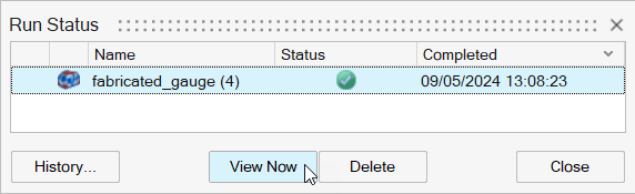

When the run is complete, select it in the Run Status window and click View
Now to see the results.

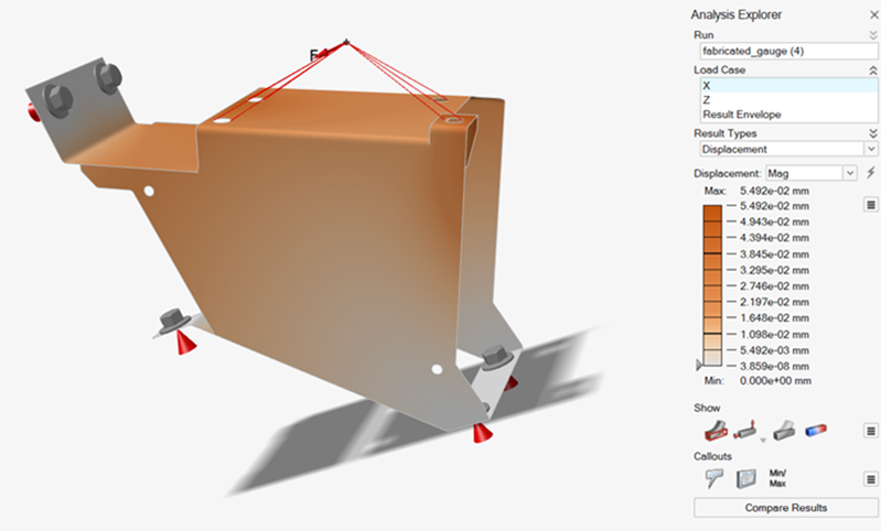

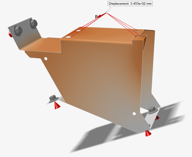

In the Analysis Explorer, select Displacement from the
Result Types dropdown and make note of the maximum
for both load cases.
We will not use them in this tutorial, but these displacements can be used as good constraints when running an optimization.
In the Analysis Explorer, click the Create, Show, and Hide
Callouts
button under Callouts and click to place a callout at point 1.

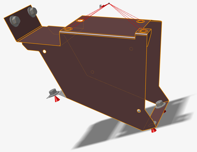

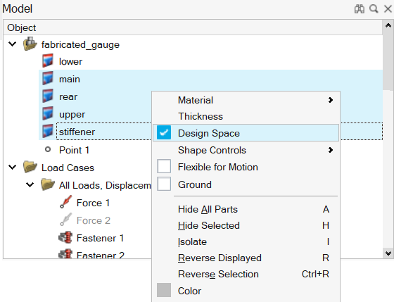

- In the Model Browser, hold Ctrl and select the main, rear, upper, and stiffener parts.
Right-click on the selected parts in the Model Browser and select
Design Space from the context menu.
Click on empty space in the modeling window.
The design spaces are shown below:

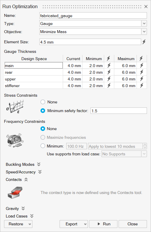

On the Structure ribbon, click the Run Optimization
button on the Optimize tool group icon to open the Run Optimization window.
Run the optimization with the following settings.

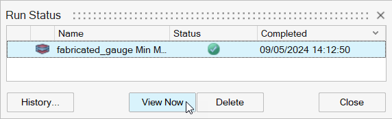

View Now to see the results.

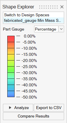

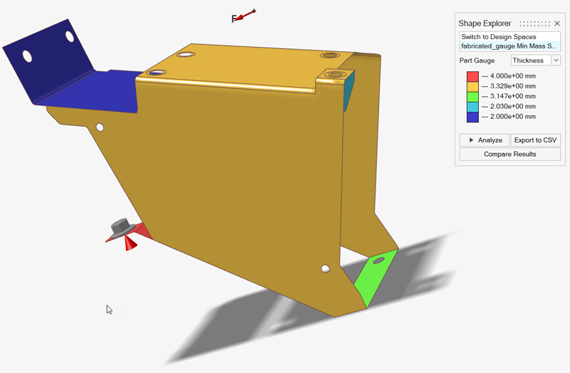

In the Shape Explorer, review the part gauge Thickness results.
Each thickness is assigned a different color, as shown in the legend.
Select Percentage from the Part
Gauge dropdown and review the percentage thickness
results.
This time the results are color coded according to the percentage change in thickness.
You can also review the mass of each design space vs the optimized shape in the
Model Browser by switching between the design space and the gauge results at the
top of the Shape Explorer.

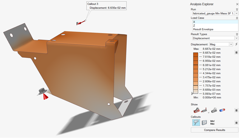

Result Types dropdown and note that the maximum for
both load cases has increased.
This is because we used a minimum safety factor of 1.5 as a design constraint. (If you wish to maintain displacement you can create displacement constraints on your model for different results.)

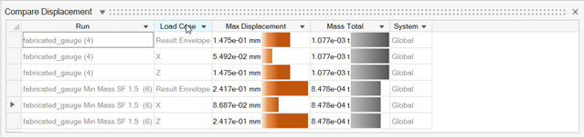

Click the Compare Results button on the Analysis
Explorer to open the Compare Displacement table.
Compare the Mass Total and Max
Displacement for each analysis run.
Comparing the baseline to the optimized analysis runs for both load cases shows that the mass has been lowered by optimizing the gauge while still achieving the stress target.
