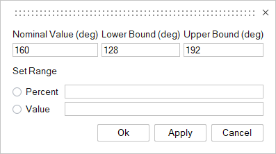

For a Continuous Variable, you can modify the following values:
- Nominal Value: Default value of the variable; also serves as the initial value in an Optimization exploration.
- Lower Bound: The minimum value of the variable range to be studied.
- Upper Bound: The maximum value of the variable range to be studied.
- Set Range: Set the range between the minimum and maximum values based on a Percent or Value difference above and below the nominal value for a Continuous Variable. By default, the range is +/- 10% of the nominal value.

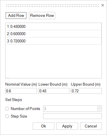

For a Discrete Variable, you can modify the following values:
- Set Steps: Set the number of steps between the minimum and maximum values based on the Number of Points or Step Size.
