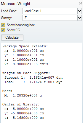

In the Measure Weight Browser, select a Load
Case.
Note: Only the forces and supports that are in the selected load case will be considered in the calculations.
- Define the direction of Gravity.
Choose from the following options:
- Show bounding box: Display the model's bounding box in the modeling window.
- Show center of gravity: Display the center of gravity in the modeling window.
Click Calculate.
The results are displayed.
