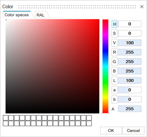

Change the color of a light - Under Light Properties, do
one of the following:
- Next to Color, select preview image. By default, it is a white box.
, then click
Select a Color.
- Define the color of the light, then click
OK.

- In the microdialog, next to
Color, select
, then click
Select a Color. - Define the color of the light, then click
OK.
