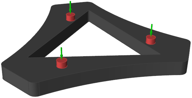

The Calculating Gate Optimization window appears. This operation may
take several seconds, depending on the complexity of the model. Finally, the optimized gates appear on the model:
Note: You can manually change the size, shape, and
position of optimized gates.
