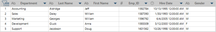

As an example, consider the following table:

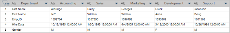

When you transpose on the first column, i.e. Department:
Each Department value becomes a column header
Each Employee row associated with the department becomes a column, and all row values are listed below each department.
The resulting transform will look like this:
The original column headers are transposed as row values of the first column and what used to be column values now become horizontal records.

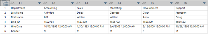

You can also transpose and use generic column headers so that the original column headers become another column:

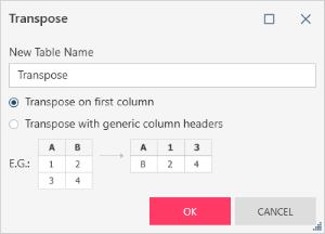

You can only transpose columns from the Prepare Window.
In Prep Data, select the table you want to transform.
Select the table you want to transform.
Select Transform on the Monarch Data Prep Studio Toolbar.
A dialog box allows you to select a transformation.
Select Transpose to display the Transpose dialog:
Select one of the following:
Transpose on first column
Transpose with generic column headers.
Select OK when you are finished.
The new table is named Transpose. You can then rename the table as needed.
