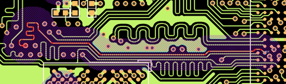

Separate Net: PollEx DFE detects existence
of shielding net(s) within specific distance per every segment. The
DFE regards only the portion of shielding net which is parallel with
target differential net.Figure 1.
Merged Net: The DFE extends the searching area with the same amount
of specific distance, then PollEx DFE
detects existence of shielding net(s) within that region. This
method is more accurate than the Separate Net method, but it takes
more time.Figure 2.

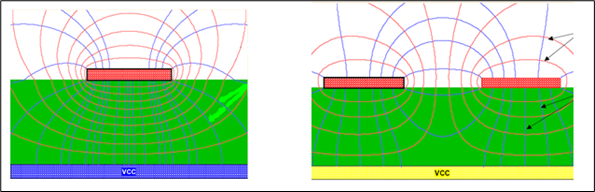

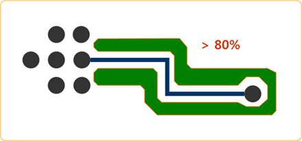

The flux radiated from each of differential signals are canceled each other because
of their polarity is reverse. But it still needs ground shielding for better EMI and
signal return.Figure 3.

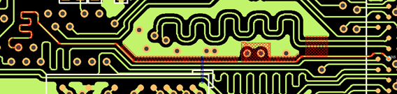

High speed signal’s 100 percent ground shielding is perfect, but it is impossible.
Over 80 percent and shielding for all routed layers are recommended.Figure 4.
