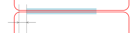

- Check Slit Width with Distance between Board Outlines: If slit width
is defined by the distance with single boards, specify the distance
value. If the distance between single boards is too close, it could
create errors while drilling.

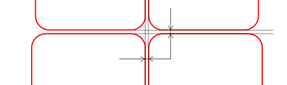

- Clearance to PCB Outline’s Corner: Set the clearance value between
the routing slit and PCB outlines corner.
Figure 3.
- Option: Define a fail if all of the PCB’s corners fail: When checking the routing slit clearance to the PCB corner, even if one side passes and the other side fails, it does not fail.

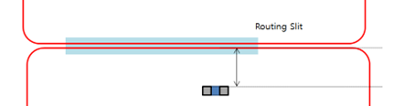

- Clearance to Component
- Recognize Selected Component’s Placed Side as Top: To define the layer, select the component. UsePollEx DFM to recognize the top layer with selected components placed layer.

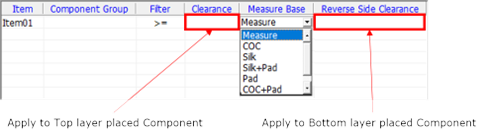

- Components’ Clearance Table: For a different component
group, define the clearance value for the placed layer and
the other side layer.
