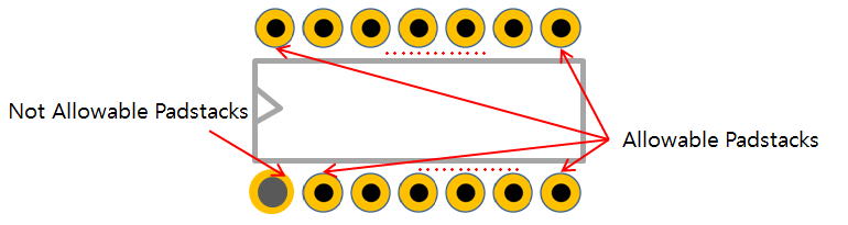

- Checking
- Find Different Pad Shape in Component: Find different padstacks than
specifying padstack.
- Target Component: Select target components from the component group list.
- Padstack Name Filter: To specify allowable padstack, define allowable padstack name with name combination. Use name filter, defining padstack name starting with, ending with or include strings.

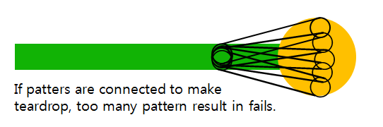

- Accept multiple connected Patterns as Teardrop for much more
than given Number: If multiple patterns are connected to pad
or via, PollEx DFM checks the
number of connected patterns and if they are many more than
given number, it is fail.
